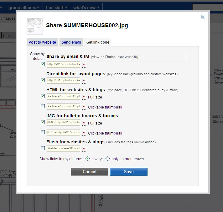

Hi Again
Thanks for all the input, it is greatly appreciated.
RHTPE, good, point a picture would definately help.
The structure we are talking about is  the bit on the right hand side  that looks like a shed on stilts.  Which is basically all it is apart from the fact it has a pitched / slated roof.
The beam is to span from point A - Point B and is  7m long  with the existing beams anchored into the house, but for ease I am looking at these as anchored simply supported beams. (The overall structure is approx 4.5m x 7m)
http://www.qems.biz/daphnia/house/house1.jpg
The house has a great deal of history to it and we are eager to preservce as much of it as we can.  Unfortunately the "Summer house" is completely rotten though years of neglect.  The roof however is perfect.  We have had an engineering / scaffolding company, support the entire roof, and the sub-structure has been removed.  At present the joists and floor are also supported and in place, but this is purely for H&S reasons.
http://www.qems.biz/daphnia/house/house2.jpg
Basically the entire structure is beaing removed and replaced excluding the roof.
Here is why we need to replace the beam!
http://www.qems.biz/daphnia/house/beam.jpg
As you can see the floor is in place and supported fromt the underside.  The existing steel structure that you can see in the picure was a temporary structure put in a few years ago as all wooden supports were completely rotten.  It isn't pretty and over engineered but it was done as an emergency situation.  The Column is a 150mm * 150mm Box Section with a 10 mm wall.
So, now that I have rambled on for some time, as you can see it is a relatively simple idea.  The reason I want to be able to calculate the beam size is, partially curiosity and partially ensuring that I know the minimum requirements when the engineering company inform me of what they are putting in.  We have spent the last 7 years putting our life ansd soul into this place, and I tend to be a bit ptotective when we get work done externally! winky smile
On that note, here are my calcs for Maximum Bending Modulus etc.

Hi Kslee100
I agree entirely I started using imperial and then referd to Metric.  All is now changed to Metric.
The simple drawings I have, but didn';t think to san and post online.

How do you put the picture in with the text?  The only way I know how to do it is to upload the file which can then be downloaded by the reader.
This seems like a much better way.  Since joining EngTips, I have wondered about this.  Is it a trade secret?

Hi not a problem, you have to store the image online somewhere. I uploaded it to our business site, then just type the following.
img http://www.qems.biz/daphnia/house/SUMMERHOUSE 002.jpg]
I have missed out the first [ which should go before the "img" to make the text show up in the post. ie. the statement
should be enclosed in square brackets []
Here is a good page which is linked to the site that give some handy hints on formatting. http://www.tipmaster.com/includes/tgmlinfo.cfm?w=450&h=450
Not sure if I explained that clear enough, but try it out and have a look at the link, there is some really use tips.
Rob

There are two ways that you can do this
The easiest way is if you own a website.  Simply upload the photo and then take note of the url that the phot appears online and place it in the [img] tags.
If you do not have this ability  then you can use sites like
http://www.photobucket.com
Register for an account and upload your photo.
Then click on the "blogger icon" (the orange one) below the photo next to the word "share".
Next click on the
"Get Link Code"
Next - copy the code in the second box down "Direct Link for layout pages"
Then simply paste this code into the [img ] tags in your post.
Seems complicated but once youh ave done it a few times it will only take a second.  If only Beam calcs were this easy winky smile
Hope this helps.
Rob
