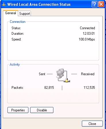

Good morning. I have been trying to talk to a ABB acs 800 with a modbus card (reta 01 ) using a laptop with windows xp home edition as its operating system. I can with this lap top have full connectivity to our works intranet and also connect fully to the internet. I can also ping our servers . However when I connect the cable to the modbus card on the drive the icons in network connections tells me the cable is unplugged. I have tried different cables with the same result. I have also connected the card to a laptop with XP professional as its operating system and this connects immediatly. Is this a XP home edition problem , And has anyone experienced this before

Is your wired port turned on and active?
Right click the wired ethernet port icon:
click on status to bring up the status screen
status screen:
If the port status is not 'connected', try "repair"

Many thanks for your suggestions . I have tried all of the suggestions above . I am going to upgrade to windows XP professional to see if this helps. Checking online suggests that there is less networking functionality with the home than the Professional editions.
