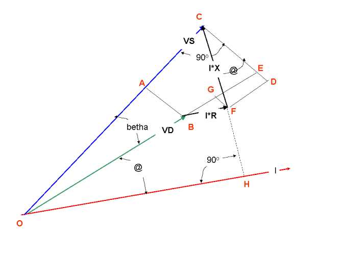

I hope this doesn't repeat but I'm not sure if my 1st post went through. I had a typo in the 1st one anyway.
I am trying to compare voltage drop calculations and I am going in circles.
I am trying to compare the IEEE exact VD formula (for line-neutral):
VD_exact = Vs + IRcos@ + IXsin@ - sqrt[Vs^2 - (IXcos@ - IRsin@)^2]
with a calculation to get the source and load voltage using vectors for voltage, current, and impedance:
Vs = Vl + IZ
VD = |Vs| - |Vl| = |Vl + Iz| - |Vl|
I can't get the two numbers to match.
example:
given:
R = 0.0204 ohms/kft
X = 0.0390 ohms/kft
single phase length = 100 ft
I = 1500 + j0 amps
so:
R = 0.0204/1000*100 = 0.00204 ohms
X = 0.0390/1000*100 = 0.00390 ohms
let load power factor = 100% => @=0
VD_exact = 120 + 1500*0.00204*1 + 1500*0.0039*0 - sqrt[(120^2 - (1500*0.0039*1 - 1500*0.00204*0)^2] = 123.06 - 119.8573 = 3.2027 volts
Since it is single phase, VD = VD_exact * 2 = 6.405 volts, which is close to a couple of simpler formulas.  This gives me Vl = 113.5946 volts
Now use AC circuit anaylsis, and start at the load end.  Since I have already said that the current and voltage at the load were in phase, I get:
Vl = 113.5946 + j0 volts
I = 1500 + j0 amps
Z = 2*(0.00204 + j0.00390) ohms
so IZ = 6.12 + j11.7 volts
VD = |113.5946 + j0 + 6.12 + j11.7| - |113.5946 + j0| = 6.69 volts /= 6.405 volts
What in the world am I overlooking?

RE: volt drop formula impasse
First of all the load seems to be a simply resistance [a big boiler for instance of 1500*120/1000= 180 kw] . Then the rated voltage of this item may be 120 V. So I=1500 A only if VD=120 V. Rload=120/1500=0.08 ohm
The resistance R and reactance X are the parameter of 2*500MCM cable[it seems to be].
Second: I don't know which IEEE standard is stated the VD_exact relation but it seems to me it is wrong.
The correct relation is:
VD=-I*R*cos(@)-I*X*sin(@))+SQRT[VS^2-(I*R*sin(@)-I*X*cos(@))^2]
From the attached sketch using a simply trigonometry you'll get as following:
VS^2=OE^2+CE^2
OE=VD+BE
BE=I*R*cos(@)+I*X*sin(@)
CE=CD-DE
CD=I*X*cos(@)
DE=I*R*sin(@)
From here you'll get :
VD^2+2*VD*(I*R*cos(@)+I*X*sin(@))+[I^2*(R^2+X^2)-VS^2]=0
If VD=x  2*b=2**(I*R*cos(@)+I*X*sin(@)) and c=[I^2*(R^2+X^2)-VS^2]
You'll get :
x^2+2*b*x+c=0
x=-b+sqrt(b^2-a*c)
So VD_exact=-I*R*cos(@)-I*X*sin(@))+SQRT[VS^2-(I*R*sin(@)-I*X*cos(@))^2]
If I=1500 A then VD_exact is 113.308 V. But for VD=113.308 I=1416.35 A
As explained dpc you have to reiterate [to put the new I1=1416.35 A in the VD_exact equation and recalculate then I2] and repeat this process until ( In-In+1)/In<.001.
Then you'll get I= 1421.11A and VD_exact= 113.69 V.
The complex calculation may be simplified starting from I calculation:
If VS is the reference VS=120+j0 V
Ztotal=R+Rload+j*X
I=VS/Ztotal
I=120/(0.00408+.08+j*0.0078)   I=120*(0.00408+.08-j*0.0078)/((0.00408+.08)^2+0.0078^2)
Iactiv= 120*(0.00408+.08)/((0.00408+.08)^2+0.0078^2)=1415.034 A
Ireactiv= -120*(0.0078)/((0.00408+.08)^2+0.0078^2)=-131.27 A
|I|=SQRT(1415.034^2+131.27^2)= 1421.11 A
VD=VS-Z*I [in complex ,of course]
VD=120-(0.00408+j*.0078)*(1415.034-j*131.27)  and you'll get:
VD=113.20-11.57j  and |VD|=113.79 approx VD_exact.
Let me try it from the basic equations.
If we assume a lagging power factor, we can write:
I = I cos  - j I sin 
ES = I (R + j X) + ER
     = (I cos  - j I sin  ) (R + j X) + ER
    = I R cos  + I X sin  + j (I X cos  - I R sin  ) + ER
Rearranging
ER = ES – ( I R cos  + I X sin  ) - j (I X cos  - I R sin  )
Ignoring the imaginary term, you get the approximate calculation, or
where the drop is the term in parentheses, which agrees with IEEE and most other sources.
If you stay with the exact approach, you get
ER = ES – sqrt[( I R cos  + I X sin  )2 + (I X cos  - I R sin  )2]
which is different than what g4932 reported as an exact equation from IEEE.  It is also different than what 7anoter4 reports.  I think he got a sign wrong.
Hope this helps.
I agree with magoo2 up to this point:
But if we shall develop the calculation we shall get as following:
ERactiv=ES-( I R cos  + I X sin  )
ERreact=-(I X cos  - I R sin  )
ER=SQRT(ES^2-2*ES*( I R cos  + I X sin  )+( I R cos  + I X sin  )^2+(I X cos  - I R sin  )^2)
( I R cos  + I X sin  )^2=(I R cos )^2+2*I^2*R*X*cos *sin + (I X sin )^2
(I X cos  - I R sin  )^2=(I X cos )^2-2*I^2*R*X*cos *sin +(I R sin )^2
And finally we got:
ER=SQRT(ES^2-2*ES*( I R cos  + I X sin  )+ I ^2(R^2 +X^2))
If we shall take the O.P. example:
ES= 120 V  R=0.00408 ohm  X=0.0078 ohm and I= 1421.11A
ER= 114.73  0.83% error from 113.79 as per last result.
That means these two relations are equivalent. But you have to know I value a priori for the second!
This error is due to the fact that here the current angle is referred to ES instead of ER and the actual
value is not 0 but  0.092090976 rad [about 5.27 degrees].If you substitute for this one you will get the accurate value.
