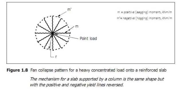

Two-way (Flat Plate) slab poured back in middle of December is just now showing cracks in last 2-3 weeks (according to GC).
- 10" thick Flat Plate Roof Slab
- Column bays are 24' x 26' (c-c)
- Cracks have occured on Top Surface only at every concrete column location.  Top Cracks follow outline of concrete column below, then radiate from corners, 45 degrees out.  Will try to upload photo.
- Cracks are very small, appear to be shrinkage-cracks.  Basically no cracks on bottom surface, and no visible deflection/sagging
- We went back and checked our design and did not find any issues.
- Cracking has occurred at Top surface of Roof Slab (Exposed Parking) - we have the SAME slab design (thickness, span, reinforcing) at the Fourth Floor Parking below with NO cracking/issues.
- Concrete Contractor says they left forms on for 4-7 days, and they placed reinforcing and slab thickness correct
- Design used 5000 psi concrete, 28 day breaks came in at 9000-10,000 psi, 7 day at 5000+ psi.
Anyone have any ideas or seen something similar?  Thanks.

I may be wrong but it looks like punching shear cracking. As to why this happens on the roof only (and not the other floor), maybe the exposed slab has suffered significant temperature shrinkage..?

The cracks do not suggest punching shear.  They suggest tensile stresses in both directions causing radial and circumferential strain in the top fibers of the slab.
Punching shear failures are rapid and do not show telltale cracking around the column before failure takes place.  The column reaction is only 24*26*125 = 78,000#.  What is the size of the column?  Punching shear stress must be pretty low.

but the crack pattern sure looks to me like something that I would expect if the load (column) was trying to punch thru. Could this occur, if the top layer of bars were set too low?
If it was flexural cracking only, I would expect somewhat concentric circles.

I agree with BAretired. The cracks are negative radial lines created by tension in top of the slab. You have to check the area of the reinforcment in top of the plate.(columns)
Do it by the yieldline-theory and check the tension in the reinforcement. If the stress is greater than the yieldstress for the reinforcement you have a bearing problem. If the stress is greater than 250 Mpa you will have a crack-problem.

The pattern matches fan mechanism (see below), suggesting flexural stresses are a primary factor. Shrinkage stresses will contribute too.

I would suspect that they are caused by a combination of flexure and shrinkage/thermal movement, although for the effects of shrinkage/thermal I would expect the external columns to crack first as these are weaker than the slab as a whole.
The circle in the middle looks too small for a shear crack. A shear crack would normally go all the way through and show some signs of vertical movement.

One of the first projects I was involved with as a graduate engineer was to 'supervise' a load test for a concrete slab that had cracked and had been repaired using a bonded topping with reinforcing steel anchored to it.  The failure was caused by the top mat supports failing and the mat was on the bottom reinforcing.  It was common, back then, to have bottom reinforcing with top mats only and no middle band top reinforcing.
The failure had produced a 'classic' yield line pattern of cracking.  The contractor was less impressed when I marked the failure pattern out with a marker to emphasise the pattern.  The facility was a technical school and the 'teachers' would bring their classes down to see the failure.
The pattern was better defined than that shown, but somewhat similar.
You should get a cover meter and determine the size and depth of the reinforcing to see that placement is OK.  Too much cover for the top reinfoccing reduces the flexural capacity but has little effect on the punching shear.  I haven't done any sums on the problem, but a 10" slab for the spans noted (off the top, wouldn't run up any flags).  A good cover meter can determine both the cover and bar size, and the design can be re-evaluated.  Repair may be a simple matter of epoxy injection of the cracks.

Sorry for taking a while getting back to answer AggieYank's question myself, but I was sleeping.  As I was the one who said the practice of pouring a column and the supported slab monolithically is stupid, I should explain my reasoning.
When you do this, the column concrete consolidates under its own weight a lot more than the slab concrete.  Therefore, the bit of concrete directly above the column can drop with the column, leaving the slab concrete supported on the formwork.
This is plastic settlement cracking, the same type cracking sometimes seen reflecting above top reinforcement in thick footings, pile caps, etc. which have not been revibrated to prevent this secondary consolidation from leaving plastic cracks.
Note that I didn't say this happened in Den32's flat plate, but it was one possibility, however unlikely.  If these plastic cracks existed, they could have formed stress risers to aid in formation of the radiating flexural cracks.

Shear is a diagonal tension phenomenon, without reinforcing, the shear capacity is highly questionable, though the equation does not consider it.
However, as stated before, I don't think punching shear has much to do with these cracks, although couldn't eliminate the possibility completely.
RE: Cracks in Flat Plate Slab
Den32,
Yes, it looks like flexural cracking.
How did you distribute your top reinforcement over the width of the panel?
Den32,
That explains part of the problem. The column strip reinforcement should not be equally spaced over the column strip width. There should be a concentration over the column and D either side. Clause 13.5.3.4 suggests this but leaves it to you to decide how much. Other codes specify specific ratios to be concentrated in the column head area for 2 reasons, moment transfer to the column and also because a lot of the moment is concentrated in this area.
EG British code sayys that 2/3 of the column strip reinforcement should be in the middle half of the column strip over the column  (ie the spacing over the column is half the spacing of the rest)
EG Australian code requires 25% of the total reinforcement (column + middle strip) within D either side of the column.
and you can go higher depending on the width of the column.  If a column were 12" wide, you could use 30% and if you have drop panels you can increase the area of steel over 1/2 the width of the drop panels.  One of the early firms I worked with had modelled the moments using deflection on a plastic model to determine the concentrations.  Per Christofferson developed the distributions.
Dik
