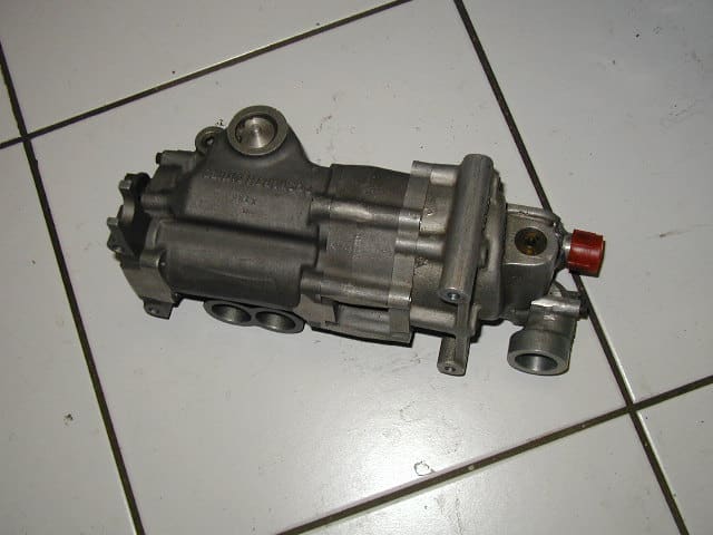

http://www.daileyengineering.com/main.h10.jpg
Picture of a pretty normal GM/Ford dry sump pan, it seems no one is too worried about oil sitting on top of the scraper.

That dry sump pump assembly by Bill Dailey is a nice piece. I did the original development work on that pump design for Nissan's GTP car back in 1989. I stole all the best ideas from Cosworth's DFX Champ Car engine oil pump and John Butera (Mr. Gasket) machined the parts to my specs. After Nissan's GTP effort folded, Bill Dailey took the pump, made some improvements, and began selling them.
Here's where I stole the design from:
Regards,
Terry

The windage effects caused by the crank webs and rod big ends will be more powerful than anything else in the sump area. So having a sump shape that directs the oil flow towards the scavenge pump inlet is most effective. Racing engines tend to have low ground clearance sumps, so efficient dry sump systems are essential. High speed rotating crank components passing through oil can cause huge windage horsepower losses.
The pressure/scavenge pump volume ratio is also important. High RPM race engines use a scavenge/pressure volume ratio as high a 4:1. This high scavenge ratio ensures a dry sump and also creates a low ambient crankcase pressure, which helps to reduce compression ring flutter at high piston speeds/accelerations.
One of the nice features of that Dailey pump is that it has a mechanical de-aerator for the scavenged oil flow. Air bubbles entrained in the oil is hard on the crank main and rod journal bearings.
Also, make sure that the cylinder head oil drain passages into the sump are not adversely affected by the crank windage.

Mechanical de-aerator? I've never heard of that before how does it work? I know the resevour is designed to do that, do most new pumps have a de-aerator or just a couple?

Not too many dry sump pumps incorporate a mechanical de-aerator. Most dry sump systems use a device called a "swirl pot" in the dry sump tank. It's just a tangential scavenge discharge inlet to a cylindrical structure in the tank that causes the heavier liquid oil to centrifugally separate from the less dense entrained air.
