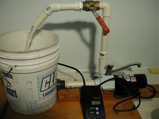

If you have a specific pump in mind just test it.  Close the valve a little more see what happens.
Here, lets try it!

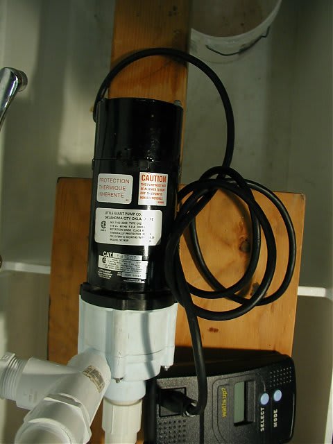

Here is the simple straight forward setup. It's a magnetic drive pump. An 1100gal/hr Little Giant.
A standard schedule 80 bulkhead was used and all piping and the ball valve are 1 inch which is the same as the pump inlet and outlet.
Close up of the pump.
A close up of the excellent wattmeter that was used.

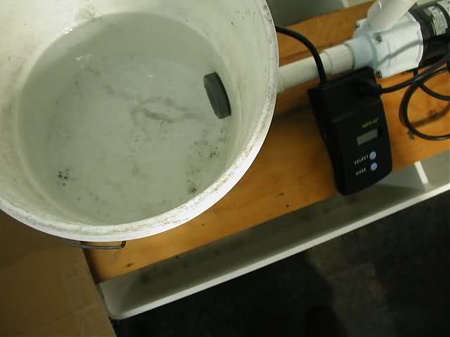

The unrestricted bulkhead fitting.
Here we go. The system running with the ball valve wide open.
The pump is consuming about 100W of power doing maximum work, which is
moving about 1100gals/hr of water. Note the solid column of water returning to the tank. 103.8W

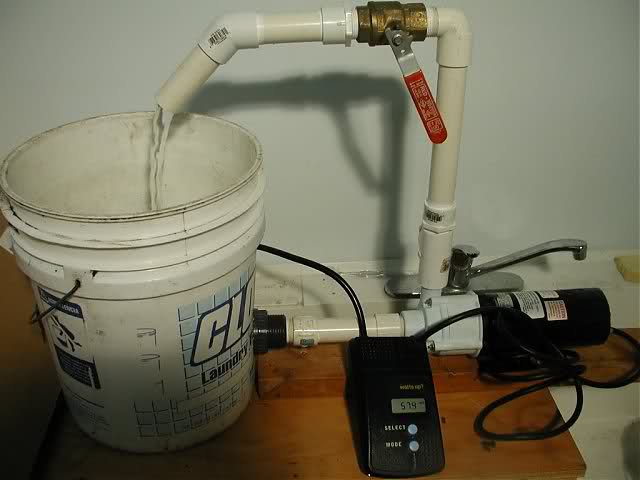

Now for some throttling. The ball valve is about half closed.
Notice the flow has dropped substantially. Notice also the power has not risen. The pump is not working harder.. It is working LESS. The power has decreased. 72.7W
Now the valve has been closed about 25%. Power has dropped still further.
57.9W
Here I have closed completely, blocked, the flow. Notice the power has dropped further yet. Of course it is not zero as there is a fan being run, bearing friction is present. Windage is occurring in the motor. There is resistance in the windings and there is some recirculation occurring in the pump head. And magnetization current.
