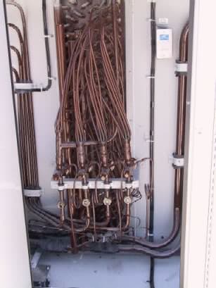

Here is sometyhing I used for a night club-- lots of outside air and large internal latent load. This was custom built by Engineered Air.
An 8 row dx coil with 4 compressors pulled the humid mixed air down to about 52F. The brown is heresite corrosion protection
In the first picture you will see a smaller compressor, its evaporator and condenser are downstream of the main cooling coil. If humidity began to rise this smaller compressor would engage, it would pull down the air temperature 2 more degrees then its heat of rejection would warm the entire air stream up. With the fan and motor heat on top of this reheat it could blow out 65F air that was bone dry.
The reheat can be in many forms, the most sinfuil is electric reheat. I prefer hot gas reheat where it uses condenser heat.
York makes a DR series of roof top units. They are dual circuit. They can be configured to run in what they call the 'alternative reheat mode' Basically on a call to dehumidify, they run both compressors. One compressor will reject its heat outside, the second compressor's heat of rejection reheats the air. You end up with a supply air condition with a similar dry bulb to what enters the unit, just that it is fairly dry. If the space needs temperature control, both compressors dump their heat outside and the unit blows cold air.
