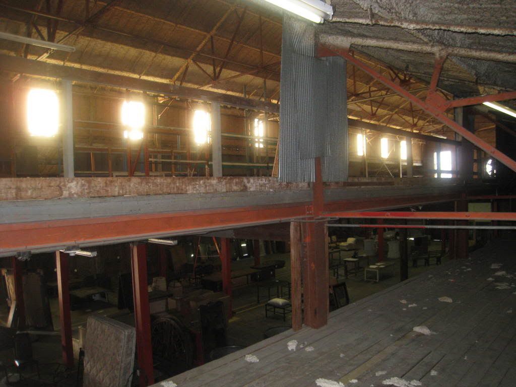

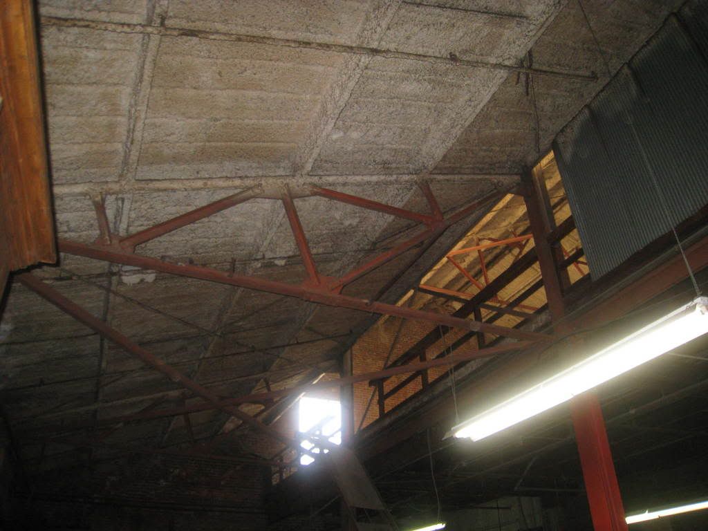

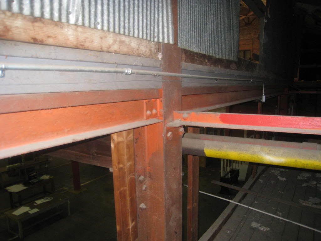

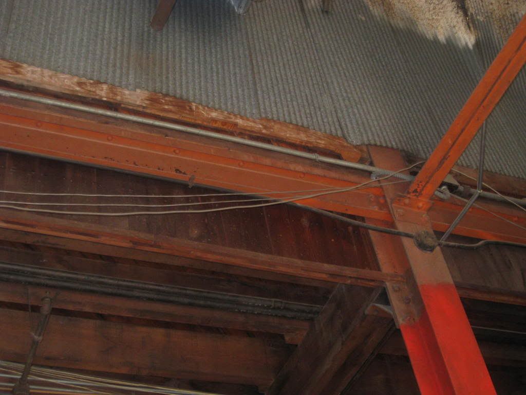

I modeled the building and found that the drift is nearly the same with or without the diaphragm.  I think csd72 brought up a good point about the unbraced length of the columns.  This is my greatest concern.  It seems that the lower-exterior roof trusses provide bracing for the columns.  It appears that the lower-exterior trusses are providing a rigid connection (maybe not the right wording) with the upper & lower chord connecting to the interior column.
I tried to attach some pictures.  Maybe they will work.

Your photos have convinced me that this building wasn't for heavy industrial use, but colud be light manufacturing, or just a warehouse as you been told.
I still think the 2nd floor was a adds-on though, because couldn't think a good reason for the mixed use of steel-wood materials, also the wood handrailing on 2nd floor. However, it is not clear from the photos, the columns at the 2nd floor seem to be smaller than that at the 1st floor. What is the main eave hight? How was the transition of column size handled (details)? Very interesting project.

Nice photographs.  It doesn't appear to me that the unbraced column length will change by removing the second floor.  Am I missing something?

From photo 2625, I have gain some confidence in your favor. I would try to analyze the full length column without intermediate brace point in the direction of web. If it works, you should be free to proceed as proposed. Otherwise, try strengthen the columns rather than relying on the lower roof trusses.

There is no bracing to the column at the lower chord of the lower truss but there is bracing at the upper chord of the lower truss. This will increase your effective length a little but not a massive amount, still needs to be checked though.
