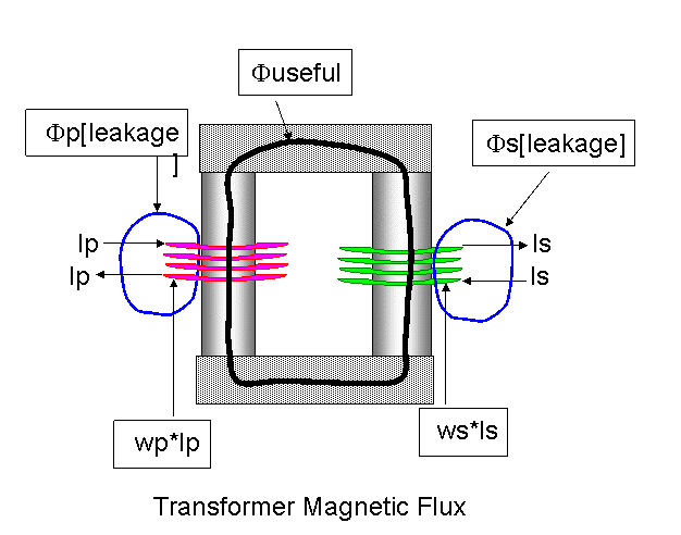

I agree with electricpete explanations and taking into consideration his recommendation of "mental picture of this idealized transformer" I shall endeavor to create this "mental picture".
The magnetic flux which produces the EMF [both primary and secondary] is
produced by wp*Io [MMF] according relation : wp*Ip+ws*Is=wp*Io
wp is the primary winding no.of turns and ws is the secondary winding no. of turns.
If Is=0 then Ip=Io.
The leakage flux is produced by wp*Ip in primary winding and ws*Is in secondary. The leakage flux determines an EMF lagging Is by 90 degrees, the same as the leakage flux produced by ws*Is does. It is a behavior of a reactance creating a voltage drop- beside the primary circuit resistance [DeltaVp]-from supply voltage Vp up to primary EMF [Ep].
The magnetic flux which produces the EMF [both primary and secondary] it is the useful flux-transferring the power from primary to secondary winding and, since it flows in the laminate core, it is sensible to the core saturation. That means Xm will change with Ep change- due to change in supply voltage or voltage drop-due to Ip change.

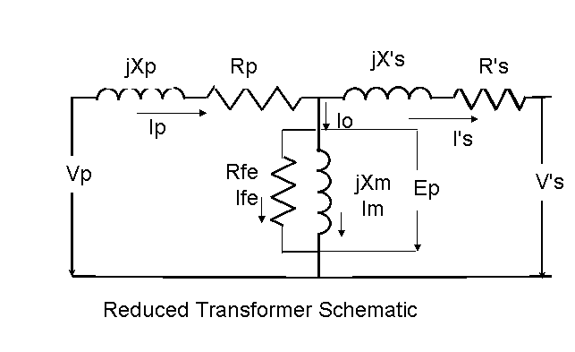

It is possible to change the scheme from fig. 1 to fig.2 if we put E's=Ep
E's = the secondary EMF related to primary.
It is possible also to add- instead Ep- Rfe and Xm and we can split the no-load current Io in two others: Ife [produces the core losses] and Im [produces Ep through Xm].
From the iron losses [FeLosses], one may extract Rfe and further Ife, Im and Xm.
Rfe=Ep^2/FeLosses  Ife=FeLosses/Ep  Im=Io-Ife and Xm=Ep/Im
