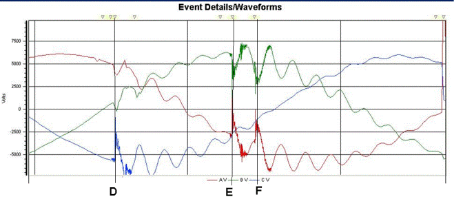

I'm looking at some wave forms of a 4160V, 600 HP, 1200 RPM motor with 175 Kvar Caps. I'm montoring the line side of the motor starter, most of the wave forms look like I'm seeing a ringing form the caps. How ever look at the start on 12_16-2008. No too sure what I'm seeing here. Any help would be gratly appreciated.

I think that currents upstream the breaker would have told the whole truth. But, without that information, we can still guess.
It looks like a rather normal interruption where there is some arcing in C and then ringing that is over (in C) about half-way through the recording.
Before that, A and B seem to restrike and start some arcing and ringing. It does so only when the difference between phases A and B has reached a certain voltage.
The three-phase voltages you see after the break are the voltages induced by the DC field of the rotor in the stator winding.

Gunnar - do your comments apply to a motor start or motor stop?  (I'm reading the question as a start).
I agree currents would have helped and voltage downstream if accessible would have helped in interpretation.
wolfie1a - Are these phase to phase voltages or phase to some derived neutral?  I assume the caps are downstream of the contactor and switched on with the motor?  How far from contactor to caps and from caps to motor?   And from the breaker back to the transformer?
It seems that possibilities to consider during start might include contact bounce, non-simultaneous closure, reflections, and possibly arcing.

Phase to Phase.  We are feeding the motor starter with a contactor that is approx. 1000 ft.  Note the feed contactor stay energized all the time.  The caps for the motor come directly off the motor stater (vac bottles) and the motor feeder is approx. 50 foot long.  The waveforms are of a motor start.  We are using a Dranetz to capture this wave.
On a side note the reason we are looking at this is on occasion, probably 2 time a year we loose other 4160 volt motors that are on the same buss.  We orginally thought we had a voltage sag problem, but after monitoring the system we found nothing.  We did a motor staring simulation with E-tap to see what a locked rotor would do the voltage and even in this case the voltage drop would not be enough to cause any problems. We had our motor rebuild shop come in and test motor, we have tested the cables, contactors, multilin and every thisng else we coudl think of.  The only strange event we have captured is 12-16-2008, the jagged edges on the ringing.

My gut feel is you are seeing non-simultaneous closure and contact bounce. I think the first spike of the blue waveform is where the second of the two poles associated with the blue voltage measurement closed.  Then the 3rd contact closed and bounced where the red and green curves spike.  At least that's my wild guess... not really sure.

I just reread the OP. He is looking at the line side voltage. So it is not a breaking that is shown. Clearly a start. Then, the bouncing and arcing seems to be the plausible interpretation.
OTOH, don't think arcing occurs in vacuum bottles. Bounce and high frequency ringing, in addition to the cap ringing, seems to be what is going on. There is also a definitive second HF transient between A and B almost exactly at 50 % time. Could be a second bounce.
Current recordings not available?

The caps are connected phase to phase.  We tried to get current readings but our Dranetz unit has a bad input... currently (no pun intended) being repaired.
Another piece of information I should have mentioned is the 4160V is on a high resistance ground system.
I probably should have not used the the term trip.  The motor just stops, almost as if you had hit the E-stop.  What we are seeing in DCS from the multilins are the NC held open contacts toggle.  There are no trip indications on the multilin.  It just as if you pulled the power off the multilin, hence our early assumption that we were dealing with a voltage drop.

In my opinion:
The harmonic waves are due to stator slots-space harmonics.
As this harmonics are so elevated it means no rotor reaction since there is no rotating field.
In D breaker is on [CV some arcing].
In E a short circuit between AV and BV may occur [both curves touch the 0 line].
In E and F the breaker tries to reconnect twice again but CV remaining out.
No rotating field to start and Multilin will open the breaker when the time is out.
Possible fault:
Breaker contacts do not close correctly [Contacts burnt or else].

7anoter4, interesting, but did you consider the time frame?  That whole image spans about 12ms.  No breaker could have done any of the things you suggest.  What ever happened at D, E, and F, it all involves capacitors charging and/or discharging, it all LCR ringing.

I see 2 characteristics:
1 - the ringing around 1.5khz I attribute to ringdown of the resonant cap circuit as others have said.
2 - the abrupt step changes followed by higher frequency (100khz?) ringing I attribute to contact bounce.
My experience is in monitoring start of motors without caps. I don't see item 1.  So I thinki it is associated with the caps.  I do see item 2 and we have monitored the load side of contactor and have confirmed it is contact bounce.  If you search the forum you can probably find my waveforms.

I have to backtrack again and clarify the only point I was trying to make in my previous hz is that the 1khz ringing is associated with caps.
My gut feel again is that the other item is contact bounce but I don't rule out the discussion of arcing.
It is my understanding that the TWF in question represented a successful start (no trip).  The scenario of 7anoter4 seems to end in trip.
