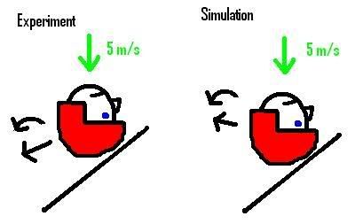

I am performing helmet testing where a helmeted head form is being dropped on an inclined plate. The head form contains 9 accelerometers so that the rotational acceleration can be measured.
The results from the experimental tests are to be used to validate the FEA model I am working with.
The problem I'm having is that the results from the simulations do not match those from the experimental tests. This is apparent when comparing the rotational accelerations from the experiments with those from the simulations. The rotational curve obtained from the experiments stretch over a larger time interval.
The FEA model consists of the head which is modeled as a rigid interior surrounded by a viscoelastic "rubber-like" material. The helmet is made of a 3cm thick liner of crushable foam and a 0.47cm thin outer shell defined as elastic.
I have performed a parametric study altering the liner density, shell stiffness, friction between helmet and plate. Altering these doesn't seem to help.
Have I missed something here?

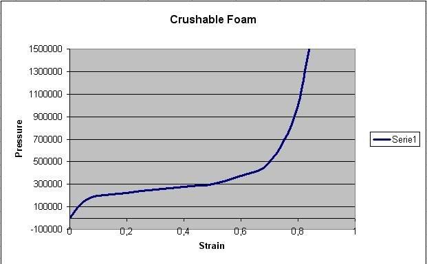

You mention crushable foam and viscoelastic materials but do you have accurate test data for the materials?  Are they quasi-static or dynamic?  Is this a standard ISO test?  I am only familiar with helmet drop tests that slide down a vertical track.  Is this for academia or a helmet manufacturer?  I hope this helps.

I should probably explain this some more:
In the experiment the helmeted head is guided by a vertical track towards the inclined plate, so it is a guided freefall.
This is for academia.
I have to agree that there is something fundamentally wrong with the FEA simulation and I think I know what:
I have recorded the experimental tests with high speed camera and it is apparent when comparing the videos with those from the simulation that they are not alike. In the simulations the helmeted head bounces of the plate much more than in the experiments. In the experiments after the impact, the helmet tends to continue roll down the plate. I have illustrated this with a high definition paint drawing down below. Note that the direction of the helmet and head after impact in the simulation is higher than in the experiments.
Since the helmet bounces more in the simulation it seems like the frictional force of the plate does not interact with the helmet long enough; the helmet does not rotate as much as in the experiment.
This was clear after comparing the rotational displacement curves of the experimental and simaltion, Thanks for that advice!
The material models of the foam should be accurate, I have reviewed the stress/strain curve and they look legitimate.
How do I get the helmet not to bounce but to rather let the frictional force have its effect?

How do you model the foam? Does it include viscoelastic effects?
I suspect that the problem is there: the dynamic behavior may be partially viscous (it doesn't recover instantaneously), and a very narrow representation of this phenomenon is required for your simulation.

thanks for the input. The foam is modeled using the data below and the loading phase follows the stress/strain curve seen in the attached image.
RO = 40.0
E= 8000000.0
Poissons ratio = 0
Tensile stress cutoff = 1000000.0
rate sensetivity via damping coefficient= 0.05

So you don't represent any viscous effects in the foam. This would result in the stress strain curve following an hysteresis cycle on unloading. However the loading phase wouldn't change much, and you have a big difference already in the first part of the simulation.
Another effect of the viscous behavior is the damping, and I see that you already account for some damping. Try different higher values of damping to see if that helps: the experimental curve appears to be much dampened than the calculations.
I would also concentrate first on the first part of the behavior. Why is it that in the calculation the rotational acceleration is zero over about 20 msec?
Assuming time zero is the first contact, why should there be such a delay? I suppose that examining your assumptions and the model you could find some answers, from here it is difficult to grasp.
