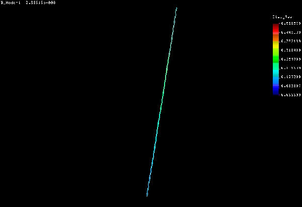

Oops! This is buckling test that I do it by Geo for first time; my test has a beam with this property;
Beam height: 100
Cross section area: 100 (10x10)
Poisson's Ratio PRXY: 0.3
Young's modulus EX: 200000
Applied force: 1 N
The results:
Max Disp: 0.5
BLF: 2e-8 for mode Num 1
