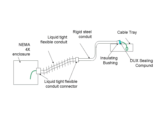

jraef is right: the grommet does not maintain 4x integrity.
Cable must be connected through a liquid tight conduit fitting using the appropriate conduit type to maintain the NEMA 4X rating.
That means in order to maintain NEMA 4X rating one has to connect the cable by means of a flexible liquid tight conduit or galvanized rigid steel conduit c/w suitable fitting.
See:
http://www.o-zgedney.com
There are more other suppliers as Thomas&Betts, Crouse Hinds and others.
