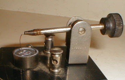

Quote (sibeen):
You may be older than I am, Gunnar :)
Yeah! You can say that again! This was the diode Gunnar made his first VFD with.
Keith Cress
RE: Ghost voltage on diode
Aah - the Galena Crystal! Those were the days.
