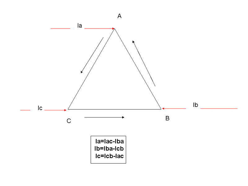

What is th proper method of determining the required/calculated cable ampacity of an unbalanced 3Ph panel.  Assume a 3Ph-3W delta configured panel that has 15kVA PhAB, 10kVA PhBC and 12kVA PhCA.  I understand the method of calulating line currents of unbalanced systems, but what is the appropriate method for sizing the circuit protection and cable?  I have been told typically that the CB or cable is based on the maximum of the three line currents multiplied by SQRT(3) not the RMS value of thre three line currents.

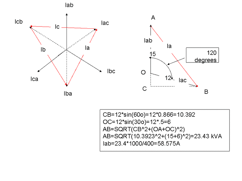

Let's say the voltages are equilibrated and equally phased [120 degrees apart].
The total S=15+10+12=37 Kva [apparent power]
Let's say the voltage [L-L] is 400 V then the average current will be=1000*S/sqrt (3)/Voltage=53.4 A
The average Sav=37/3=12.33 kVA and the maximum 15/12.33=1.216
So the maximum may be 53.4*1.216=65 A
This is a conservative solution, but not exaggerated.
If you know the current phasor [vector] angles you may calculate exact the line currents.
According to relation Sum(I) =0 in one corner:
Ia=Iac-Iba ; Ib=Iba-Icb ; Ic=Icb-Iac
If the supplied device is a heater for instance the pf=1 [pure resistance], so the current angle with respect the voltage angle will be 0.
In order to measured the actual angle if pf<1 you need a single-phase wattmeter and the angle with respect the voltage will be = arccosine (P[watts]/S[VA]).
All it remains is plane geometry [in order to calculate one edge when you know the other two and the
angle between in a triangle].
Iab=23.4*1000/400=58.575A  [11% less than above approximate calculation.]
