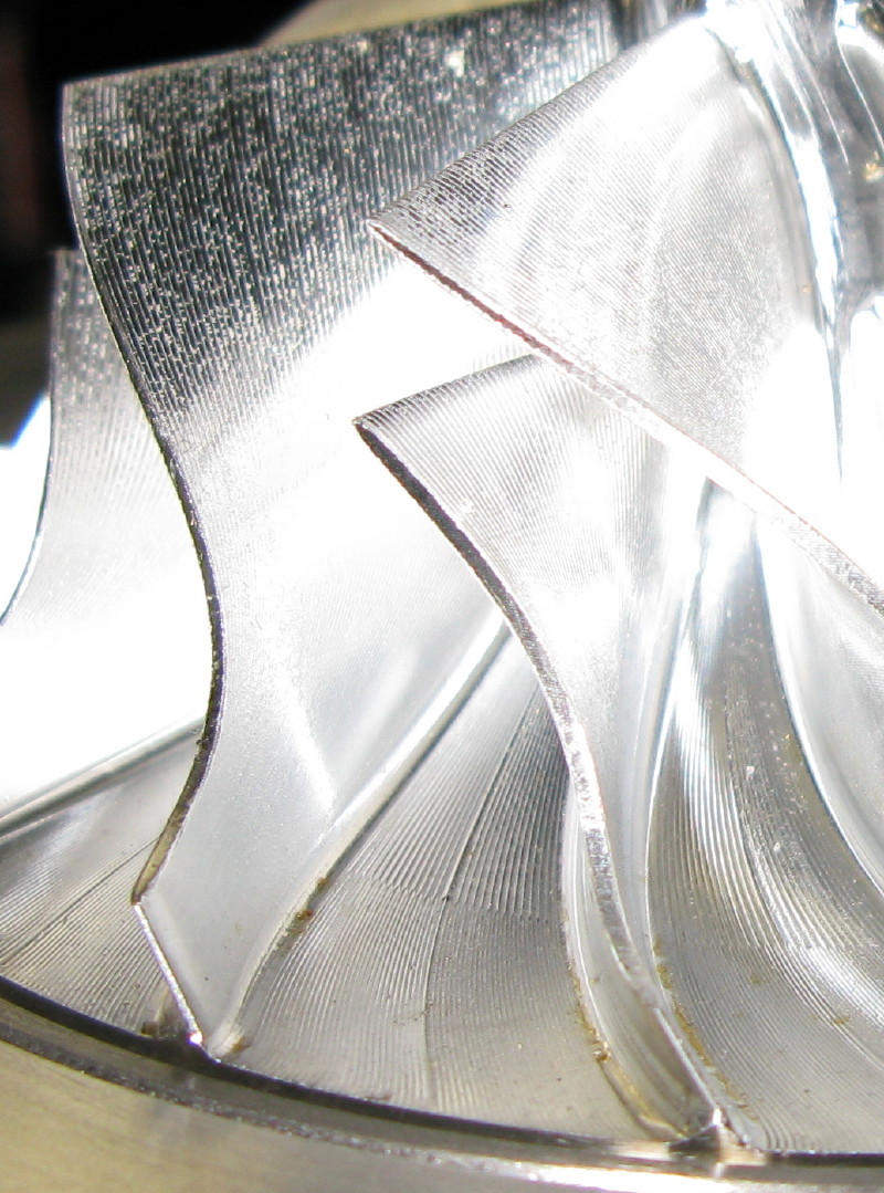

CoersDiesel, in reference to your photo of the billet compressor wheel, the marks are naturally there due to the CNC machining process.  What reason do you have they are there for any other reason?
RE: Intake Valve Design(Diesel)
Ummm, I meant to write "what reason do you have to believe ...
That was the closest picture I could think of that would mimick the idea that I was thinking of.  I am not really versed on the design elements of compressor wheels, however I could see some benefits from the grooves in the form of adhesion and channeling of the air.
