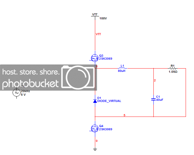

I'm pretty new to PWM design, and I haven't seen any examples of how to drive a dual switch PWM.  Every example I've seen seems to only drive a single mosfet tied to ground.  No matter what I do I can't seem to get the switches working, at least in the simulator.
What I want is both switches to turn on at the same time, turn off at the same time.  But I can't even get them to turn on.  What do I need to do in this situation?

One way is to create a floating 15 VDC power supply referenced to Q3's Source and use an Avago Optically Isolated Gate Driver.

International Rectifier has some driver IC's for this.

IR2103 (high side low side driver) looks like it should work great.  Can't find a regular spice model for it though.  Tried using the pspice model that IR provides but it makes multisim crash.
Guess I'll order them and bread board it to see if I have the layout correct.
