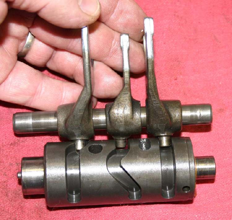

I am trying to model a part in Pro E and I'm really struggling. Imagine something like the gear selector drum in a motorcycle gearbox. So in other words if I were to plunge an slot drill into a cylinder perpendicular to the axis and then rotate the cylinder an eighth of a turn while moving the cylinder an inch along its axis, then continue to rotate it by a further eighth of a turn while moving the cylinder back by the same distance in the direction it came from, I will have created a V-shaped slot around the circumference with a full radius to each end of the slot and a radius in the bottom of the V.
I have tried doing this using a Helical Sweep Cut both Through Axis and Normal to Trajectory, neither has given satisfactory results.
The trouble with doing it through axis is that the slot becomes too narrow so I have try and work out a width which will work out correct when projected at the desired pitch plus the ends of the slot don't end up square to the walls of the slot.
The trouble with doing it normal to trajectory is that I end up with a ridge in the base of the slot at the V and the walls of the slot do not appear to be square to the base of the slot for some reason.
The trouble with both is that when I try to put a round in the V of the slot it does not come out normal to the spine of the original intersection (despite me selecting normal to spine).
I hope all of that makes some sense to somebody as it has me beat. I will try attaching the model.

Attached shows the issue with rounds, they don't remain perpendicular to the spine. I just can't get it to make the shape that the milling cutter would.
This pic shows the sort of slot I am trying to achieve
http://www.dansmc.com/shaft_shifter2.jpg
I'll try doing an offset surface, but I'm not really sure how.

So this got me playing with the wrap command, and it does exactly what it says on tin. I might be able to get the wrap command to work for me if I can find a way of turning it into a cut. So far I have tried offsetting the suface of the cylinder and then wrapping the sketch onto that new diameter surface then doing a boundry blend between the two 'wraps'. Unfortunately this again creates a surface which is normal to the sketch not the surface of the cylinder.
If you do a google image search for gear shift drum you will find some pics of the type of thing I am trying to model.
There has to be a way of doing this, I just can't believe that something so simple can be so dificult to model.

Groove sides are no problem.  Sweep a surface representing the
cutter axis trace and thicken cut.  I wouldn't worry about groove
bottom as I don't believe it can be correctly modeled in Pro/E.
-Jeff Howard (wf2)

Thanks Jeff, v.helful. Took me a while to figure out how you did that veriable section sweep as I have never come across Trajpar before! Done a bit of rading up on it and also found datum graph feature which may help me define the acutal path.
Reading your posts in that other thread I see what you mean about the base of the groove, more complex than you would initally expect.
I'll have to have a play with it as a lot of this is new to me but I'll keep you posted.
Cheers.

I think I have finally got one of the grooves done, just two more to go at different radial offsets around the cylinder.
Jeff does this look 'right' to you? In so much as an 8mm peg will follow it around moving 10mm one way then 10mm the other. I'm aiming to go from the 'neutral' position to 10mm one way in a 1/16 of a turn, then to 10mm the other way in in 1/8 and back to neutral in another 1/16.

Basically I created graphs (each of the vertical construction lines in the graph represent 1/8th of a turn along the circumference of the cylinder), one graph for each of the veriable section sweeps driven by relations refrencing the graphs.
I then created a boundry blend between the tops of each of the variable section sweeps and thickened that to cut the groove. Hide the veriable section sweeps and other refrence geometry and hey presto. The final thing I did was to extrude a smaller cylinder inside just to 'clean up' the suface forming the base of the groove.
I don't have mechanisms so can't check it with that, but it looks like what I was aiming for. Whether or not I have gone about it the right way I don't know.
