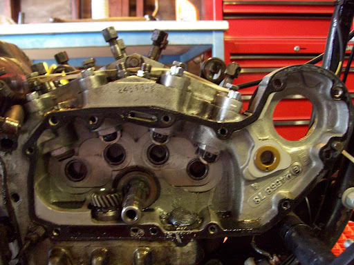

I have a 79 Ironhead and I'm fairly certain I'm dealing with some sort of reversion problem. I've done every test I possibly can in regards to ignition, and fuel and I know that neither of these are the cause of my problem. There is good compression on both cylinders.
I can't get the bike at suggested idle rpm at all. The rear cylinder is firing but is very weak. When the bike is idling I can pull the rear plug wire and not a lot changes. When the front wire is removed the bike falls on its face and dies. The front cylinder is running super rich and the rear seams to show little to no color on the plug.
At idle the carb spits a little fuel here and there and when the bike is shut off it appears to have steam coming out of the carb. I pulled the intake manifold and carb off and both intake runners are soaked in fuel.
I know cam timing can very well be an issue but I pulled the cam cover off and the cam timing was spot on. The rear exhaust pipe sounds almost like a under water boat exhaust or something. Also, When I unplug the rear cylinder while idling and leave it unplugged for a few seconds, When I plug it back in I can get a few strong fires out of that cylinder until it goes back to the way it was.
So with all this being said I'm fairly certain I'm having a really bad reversion problem that's keeping the rear cylinder from running right. If its not cam timing what else can it be? I'm runnin out of ideas and I really want to start riding before the weather gets bad. Thanks in advance fellas.

The cams looked to be in good shape and weren't missing any lobes.
I'm pretty sure the ignition timing is fine cause the front cylinder is firing good and is really strong.
The engine only has one carb that feeds both cylinders. I've tried to different carbs and nothing has changed. Also if it was a carb problem I'm fairly certain it would effect both cylinders.
A valve sticking or a broken valve spring is very possible.
Every single ignition component is brand new. I have tried different wires to just in case and still no change.
The exhaust isn't blocked at all.

The next part I'd buy would not be a part, but a tool, a degree wheel.  They can also be downloaded and printed.
1979 ironhead = sportster
sportster = 4 independent gear driven cams
http://lh6.ggpht.com/_gAeOQKjnQms/RzgWB1UCf5I/AAAAAAAAAJk/WgS6QgH8HJw/100_1389.JPG
http://home.sandiego.edu/~ekim/harley/tstorm/bike1002o.jpg
that makes it at least 16X more likely I'd mess up the timing on at least one of them.
Rather than pull the cover and check the various timing marks, I'd locate and record the actual valve opening and closing timing events.

The sporty does have 4 cams but the marks are very easy to see and it would be very difficult to miss align even one of them. Also the teeth on the cams are pretty big so if one was off even a tooth it would be very apparent.

I was thinking about the cam thing tonight. The cams are numbered 1-4 from left to right. The #2 cam (rear cylinder intake) runs off of the crank and then drives all three of the other cams. If the #2 cam was off then both the intake and exhaust cams for the front cylinder would be off as well. Also, The points system runs off of the #2 cam.
So I guess we can all assume the #2 cam is fine because the front cylinder runs perfect. Both ignition timing as well as cam timing for that cylinder is ran off of the rear intake cam (#2).
With that being said it makes me wonder if something is up with the rear exhaust cam. I know its lined up cause I checked them awhile ago but it makes me wonder if maybe the lobe is worn or maybe it was stamped a tooth off from the factory. Also, I know the rear cylinders intake cam is timed right but the lobe on that cam could also be worn.
I'll loosen the push rods tomorrow and see if that helps. If it doesn't I may try to get a new cam set and see what happens. Any other ideas fellas?
