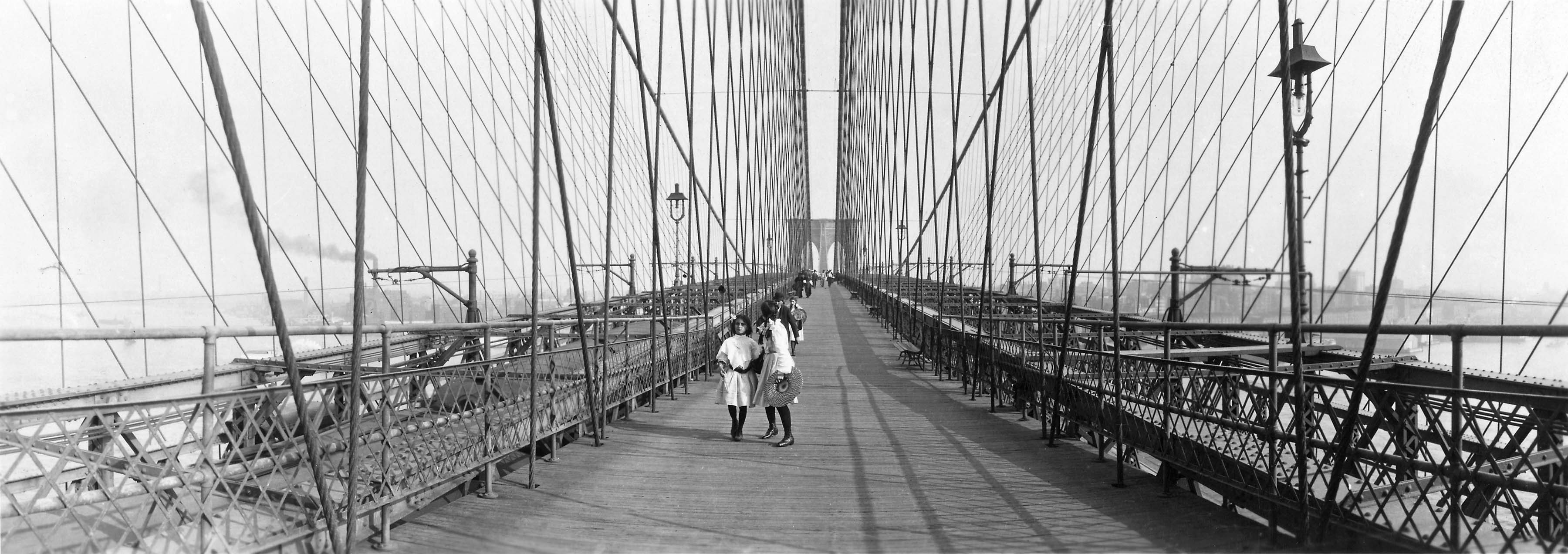

why did john roebling design the truss to have longitudinal top and bottom chords as continous?
see picture here
http://www.archives.gov/press/press-kits/picturing-the-century-photos/images/pedestrians-on-brooklyn-bridge.jpg
RE: brooklyn bridge why design cords as continous beam?
How do you know that the design was modeled as continuous?  If the joints develop restraint, then the continuous model may be conservative with bending included in the chords.
in a book by McCullough it says "The inclined stays would have a strength of 15,000 tons,enough to hold the floor by themselves.If all four cable were to fail , the main span would not collapse.it would sag at the center but would not fail"
i am guessing this is why the top beam  and bottom beam is continous.(the picture i linked to shows the moment splice)
Anyone agree or disagree?
Design trusses with hinged joints also would not fail if interior supports are removed.  No moment connection shown when I opened the picture, just cables and road deck.
