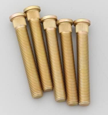

Hi Everyone,
I am having trouble finding what I would call a carriage bolt, it looks just like a carriage bolt except that it has a spline round shape under the head instead of a square shape that is usually under the head of a carriage bolt. The round shoulder under the head is a fine spline that looks about 8 mm long.
The bolts are used to secure a steel gas tank support arm to the frame of a truck.
I need a source of supply I can order from here in the USA but I'm having trouble finding this item.
Thread specs = 10 mm OD X 1.5 mm pitch
Length under head = Need at least 40 mm long but can cut down a longer bolt if needed.
Head diameter = Approximately 20 mm OD, but can use a little larger if needed.
Grade = Prefer a 10.9 class or whatever the strongest grade available is.
The round spline shape or shoulder that is directly under the head has an 11 mm OD.
I have tried local hardware and autoparts stores along with www.mcmaster.com. I also looked through the www.auveco.com/ catalog but have not found anything yet.
Does anyone have an idea of where I might find something like this ?

The longitudinal pattern on the shank is referred to as splines or serrations.  These are common on wheel studs.  Does your part look something like this?

Thanks for your replies guys,
Cory, yes, it looks just like your picture of a common wheel stud, except with a bigger head that looks like a standard round carriage bolt head.
It does not look like the picture shown at the fastener- plus link given by Trevor because the "ribs" or splines are too course and too long. The spline on what I need is like the fine splines on the wheel studs.
What I need is just what is shown in the picture Cory posted, except with a standard carriage bolt round head.

I think this type of fine spline carriage bolt is probably a custom made bolt that was used to speed assembly at the factory. After you insert the bolt into the hole, you don't need two wrenches to torque it down since the splines keep the bolt from turning as you torque the nut down.
I just went with a 7/16" thread OD, grade 8 hex / flange head bolt and a grade 8 flanged nut.
