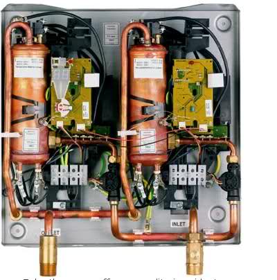

Your wish is my command...
This is a double unit.  We have a triple unit. Each unit has three heating elements and is 9.6kW.
Note the black round thingyies. Those are the flow detectors.
The top of the tanks have something going on??? Is this a continuation of the dotted box maybe?  Still what is the point?
The white clips on the outlet lines are the exit water temp sensors.
burnt2x; That Lineleftside brought down to the bottom box makes zero sense to me.

I think the idjit box may have the neutral point since 1 2 & 4 (why not 1, 2 & 3 ? - shrug) should be joined to close the ckt. I would remove the tap between 3 & 5 and put the third phase on 3 and then ground the neutral (in the box)
The taps from 3 & 5 to the black box at the bottom should be for lamps, control contactor ?
Question on hydraulic ckt. Where is the center tap on the water inlet top going ?
What does the regulator marked 1 to 6 control ? Water flow ?

My guess is some sort of temperature control. You need something to compensate otherwise the temp would depend on flow rate.

Looks to me like there are three thermostat (in the black box) controlled elements that heat the water faster depending on the water temperature.
I don't think you could easily connect three phases.  Consider that you would have to connect them inside the black box and that you would need to connect the elements phase-to-phase not phase-to-neutral to get the proper voltage across the elements.
RE: Mystery Box
Looks as a phase control unit (triac or antiparallel SCR's). All of the heaters are connected  with one lead to the same phase terminal. Other lead of the heaters may be connected together inside the box and then to the phase control element. The wire connected to the phase lead may be needed for the SCR pulse synchronization.
Basicaly, chopping the line voltage the RMS power delivered to the resistances is continuously controlled.

I'd agree with the others. There's likely a flow and inlet/outlet temperature sensors and the "box" is a PID based voltage controller that regulates the heater voltage and hence the power output to try to maintain the output water temperature.
If you have a triple unit you could likely put each "stage" across a different L-L on the 3-phase to get a somewhat balanced load but that'd be the best you could achieve.

Thanks all!  These type heating elements burn out in an instant. Rather like a flash bulb filament, so I bet you're correct on them even monitoring the pressure.
I think ratz1 may indeed be on to something.
Each 'unit' seems to have a fairly large electronics control board which could explain/support some sort of PID scheme.
I'd just thought the contacts were opened and closed to do the control but that would be a lot of opening and closing of mechanical contacts.
edison123; That center tap on the inlet (I did a double take on it after you pointed it out), just loops over to join the manifold from the top.
I wonder if the switching elements are actually mechanically associated with the water tanks for cooling?  That would make heatsink/efficiency sense.  That would explain the dotted mystery box since the picture of the tank is inverted in the schematic.
LionelHutz; That was my thought as each module needs 240 and appears to be independent otherwise, except for a communications wire.   We are attempting to get an answer from the maker about 3ph otherwise this whole thing will go off the rails because our 52kW generator will NOT appreciate a single phase load of 29kW...

Looks like the brains to me. These things usually have a mess of SCR's or similar devices to control the heating elements. The ones I've seen use the water tank as a heat sink for the SCR's. I'm guessing that's what's in mystery box. It's using the 240V from the switch and term 3 for its power supply and shunts the heater terminals 1, 2 and 4 back to the left Line terminal.
I'd bet the SCR's or whatever just turn each of the three heaters on or off as needed to supply water of the correct temp. I doubt there's anything as sophisticated as chopping going on. Besides that would create a really nasty waveform.

The good news is that the maker came back with, "Oh sure you can hook up those three modules on three different phases".
