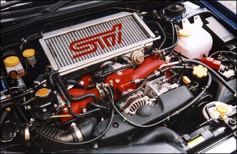

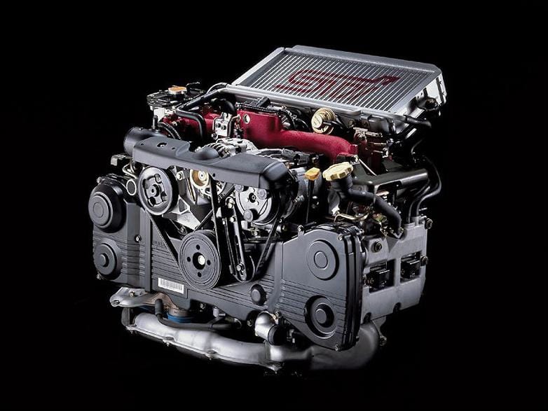

izzmus, yes great idea, to upside-down mount the eaton below the intake manifold. Is there enough clearance room there?
Additionally, I had always hoped of fitting an A/W intercooler after the eaton, that would take at least an additional inch of space for a highly compact solution. Perhaps spacers where the intake manifolds meet the heads (if they meet orthogonally)
twincharged AWD sounds like the ducks nuts as you wouldn't be spinning the wheels like rwd may do if you have too much torque off idle
RE: Twincharging with Screw-Type SC instead of Roots
A custom intake manifold is assumed.  Fortunately, Subaru saw fit to make the turbo engines (for the North American market at least) with three piece intake manifolds, with the fuel injectors and rails attaching to the lower stubs.  A custom intake manifold is not therefore going to be nearly as time consuming to fabricate as it could be.
Believe it or not, my plans are for front drive.  As it will be entirely on an experimental, beer-money type basis, I don't want to have to deal with the reputation for drivetrain breakage that Subarus have earned.  Not yet, at least.
FWD in what body? An imprezza or liberty, or something entirely different?
Here's some pics:
Alternator, Power Steering Pump, AirCon Compressor - which one are you going to remove? Or, will you accomodate them with a bracket to re-mount it a little to the side? :)

Well, just a short update on this one :) today I bought an EJ255 which is the 2.5 litre turbo engine as used in the Subaru WRX 2006+ models
Have also decided that I won't do an engine transplant, but I'm going to design a car in Pro-E software and then build it
:) Also, I'm stoked at the price - I got it dirt cheap! $300AuD which is about $200 USD
how cheap is that! spun bearing or something, which doesn't matter cos I'd rip it open anyways~
