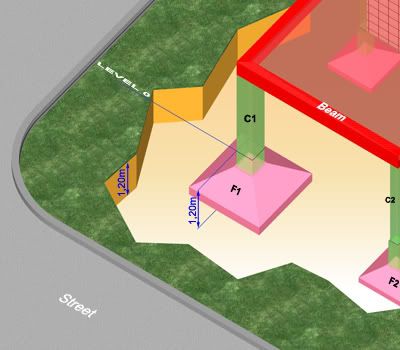

I have to design the corner column (reinforced concrete) for a two-story house at the crossing of two streets, C1 in the picture specifically.
If loads controlled the design, it would be a 20cm x 20cm column with #4 bars, like C2, etc. However, corner columns are given a special consideration due to the potential risk of being impacted by vehicles, which takes precedence over the DL + LL static analysis. It is not uncommon for corner columns of ordinary houses to have a diameter of 50cm or more (or 40cm x 40cm if square) and be heavily reinforced as well. I skimmed ACI 318-08 but didn't find anything in this regard.
Now, my questions are: What is the common practice for designing reinforced-concrete corner columns subjected to the (potential) impact of vehicles? What is the detailing like? Which shape is more convenient, square or circular? Can the longitudinal reinforcement be spliced in these columns? My intuition says it shouldn't... Is it sensitive to use spiral rebar for shear?
Thanks.

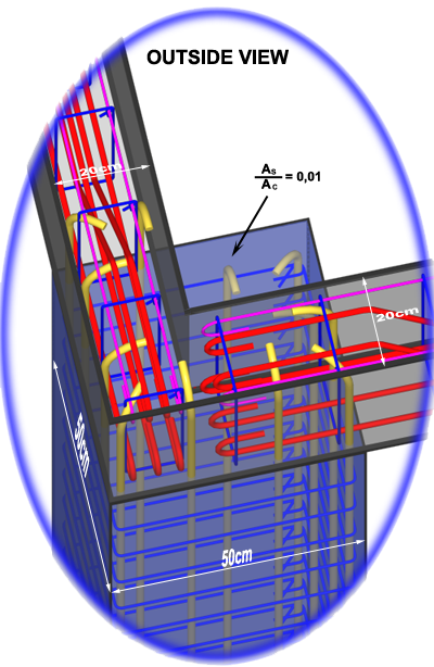

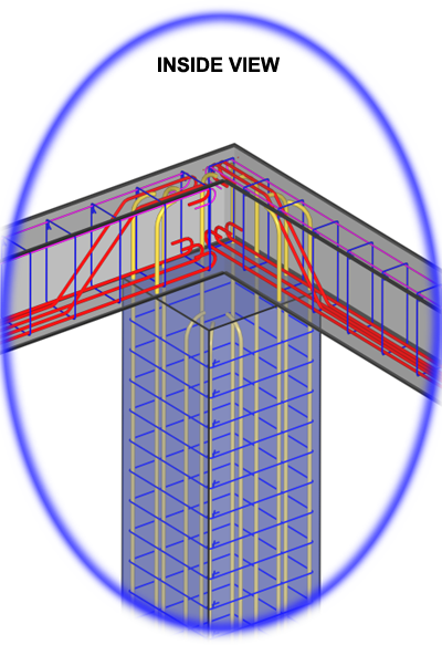

I might consider reinorcing the beams so that they  possibly survive if the column was completely taken out - Some call this redundant engineering - big in blast analysis where the loss of one column does not doom a structure.
What would you change in the following design ? Too much congestion at the encounter of both beams doesn't leave room to interweave the rebar. Does it make sense? (see pics.)
Thanks.

In the absence of other recommendations, I would take steps to provide as ductile a column as reasonably possible.  For instance, provide extra ties for confinement.  Doing this for the beams tying into the column may be a good idea also.  Keep looking for load information.  Using impulse and momentum to arrive at a design force may be possible, at least to a certain degree, though I wouldn't want to go that route.
