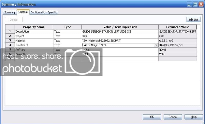

See where it says Harden R/C 57/59.. I want there to be a selectable list of different hardening levels. Every time I hit "edit list" it just allows me to add a property to the "Property Name" column drop down.
Thanks!
RE: Can you edit this list?
No, that dropdown list cannot be edited.  It will only show SW default property values and any global variables/equations.  If you want a customized dropdown list for properties you will need a custom property editor macro.  There are quite a few floating around.  I don't have a recommendation personally on any of the available ones because I wrote the one that we use, and it's highly specialized for our company.

SW2009 will have a Custom Properties Tab Builder that will allow you to easily do what you wish to do.
For earlier versions of SW you will have to write custom code or get an already written macro program.

Most of the custom property editors available are either "professional" ($) or provided as is for your personal customization.  The one I pulled together is provided as is, but is close enough for many applications: http://sw.fcsuper.com/index.php?name=UpDownload&req=viewdownloaddetails&lid=7
