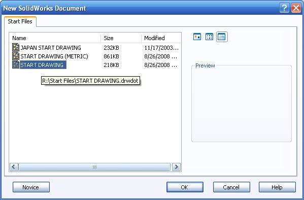

We have three templates
Japanese
Metric
English
For this I want english

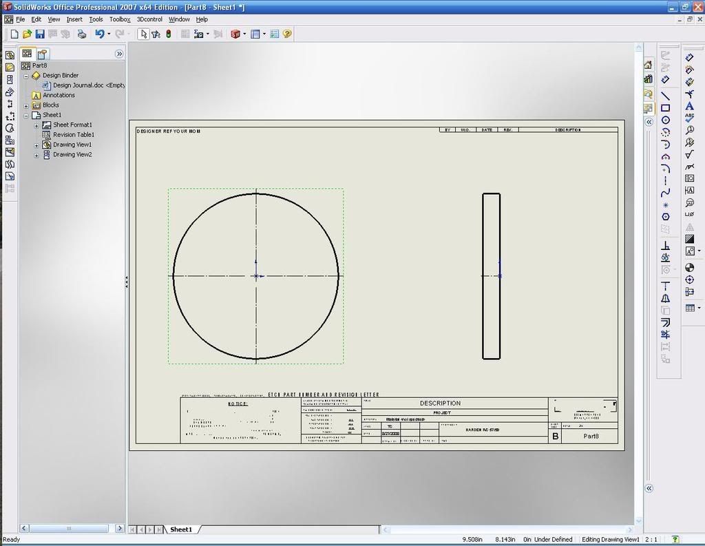

It comes up like this. As you can see revision table is in the correct spot.

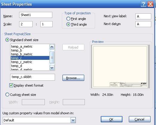

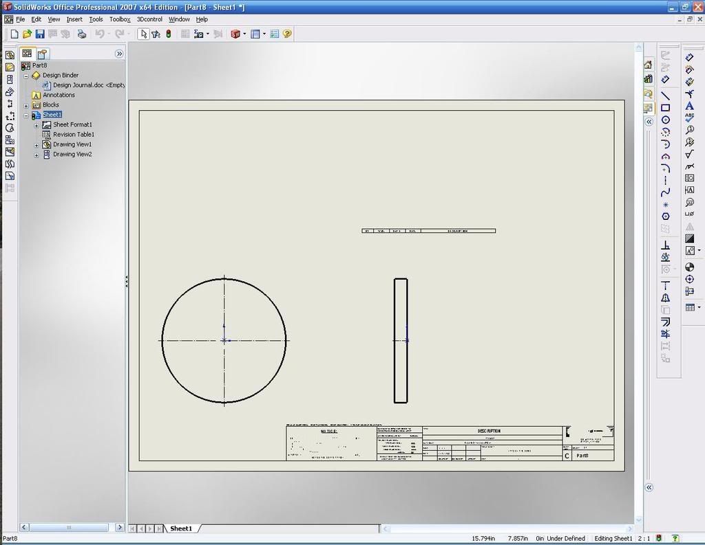

Now I want to change the sheet size to a C. I do that
and now my revision table is not anchored in the right spot
I have went into every sheet format and made sure the anchor  point was set to the top right hand corner.

Just received this from my VAR
" I will submit this to solidworks on your behalf. The workaround is to edit the table setting then toggle off attaché to anchor then toggle it back on. It will snap to the anchor point of the new format. Just seems to me like they are not recalculating this."
Seems to be an issue with SW.
RE: auto insert 3 standard views?
VAR just emailed me stating that the problem also exists in SW 2008.
Now I have to have 8 designers double clicking the attach anchor button to "refresh" it when changing sheet sizes for every drawing. Ugh. I hope SW finds a fix to the problem.
