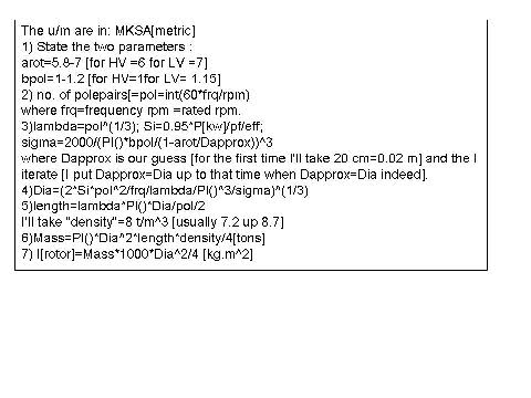

RE: Induction motor Inertia
The moment of inertia may be included in the manufacturer data as:
GD^2 [metric] in to variants: in kgf.m^2  or kg.m^2 where kgf.m^2=gmetric*kg.m^2 [gmetric=9.81 m/sec^2 gravity acceleration]
Wk^2[British] also in to variants in lbf.ft^2 or lb.ft^2 where lbf.ft^2=gbritish*lb.ft^2 [gbritish=32.19 ft/sec^2 gravity acceleration]
I [or J] =GD^2/4/gmetric if GD^2 is expressed in kgf.m^2 or I= GD^2/4 if it is kg.m^2
In British units I=Wk^2[lb.ft^2] or Wk^2[lbf.ft^2]/gbritish.
Then 1kg.m^2[GD^2] corresponds to 5.933 lb.ft^2[Wk^2]
If one knows rotor Mass [kg or lb] and the rotor diameter [m or ft] then I=Mass*Dia^2/8 [kg.m^2 or lb.ft^2].
If one don't know rotor Mass [kg or lb] and the rotor diameter [m or ft] then [as a [very!] approximate mode of calculation] one could calculate as follows:
Regards
