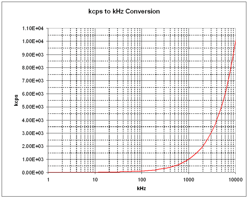

RE: Meausing voltage across a shunt resistor with an oscilloscope
Please fill me in, this is the first I've seen the acronem 'kcps'.
Thanks.
It's an old frequency measurement term. Here's the handy graph for converting between the two units that others have referred to.
Glenn
geek, thanks for posting the graph.  I'll have to super-size it and print it out to hang on the cube wall for reference. winky smile
