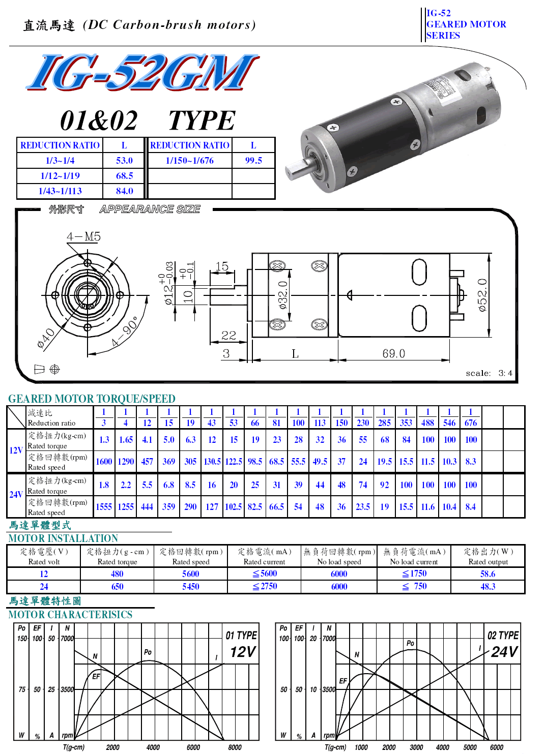

I found on the web this:
These 24VDC Type 02 52mm diameter gear motors are made with steel gears (not plastic or sintered metal). They are real stout motors. They weigh about 2.9lbs each. We sampled many other manufactures and the gears would strip or the windings would burn up, we had no failures with these.
These are the links:
http://www.superdroidrobots.com/product_info/IG52GM-02.gif
http://www.superdroidrobots.com/shop/item.asp?itemid=841&catid=7
