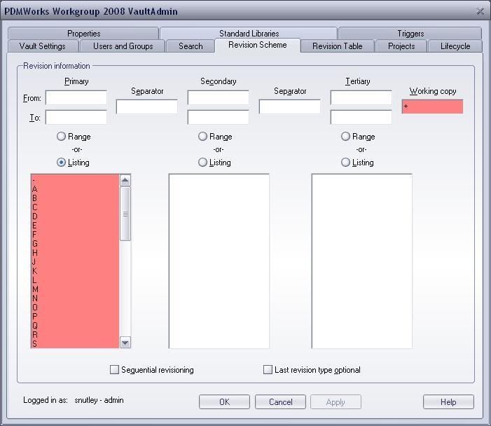

'm having a problem with revisions. We only use one letter A-Z for our revisions and a new drawing doesn't have a revision letter. In our PDMWorks options I use a '-' as the revision before 'A'. I also use '+' for the Working Copy. A drawing can get checked in multiple times before it's complete as the lifecycle 'In Progress' and the revision level shows up as '-+'. When this drawing is finished, it gets checked in and the lifecycle gets changed to 'Approved' but the revision level stays at '-+'. That seems to be OK but once a revision is done later on and checked back in at 'A', you can no longer view the original copy '-+' anymore.

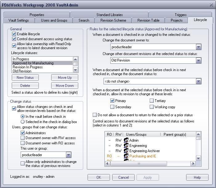

We have our PDM Lifecycle set the 'Approved' status to Primary rev status only, so when you release a drawing the working copy "+" goes away

We also have our 'Approved' status to Primary only but the '+' doesn't go away.
I can pick which Rev to open but it only gives me the option of Rev 'A' or 'B'. Rev '-' is no longer available. (I've attached a screenshot)

Are you working from a list of Revisions for your scheme where - is the first?
(Also, not your question, but just a reminder not to use the letters I, O, Q, S, X and Z for revisions or any identifiers on drawings per ASME Y14.35, because even though we live a the digital world, these characters (except for X) can still be confused with numbers and can be transcribed incorrectly at any human step...and X just looks like an unfilled field.)

cadmgr2004: I'm fine with working copies not being preserved. I just need to be able to go back and see all major Rev levels. (-,A,B....) I can go back and look at A and anything after. My problem is going back to earlier than A. The first Approved first version '-' is the one that I can't see.
fcsuper: Yes I'm working from a list of Revisions and '-' is the first. I've attached a few screenshots of our VaultAdmin settings. The two lifecycle screens shows the two status' I'm talking about. 'In Progress' is where the working copy should be used but once it moves to 'Approved' then it should have it's first Rev level '-'.
