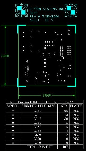

Hello,
I have recently layed out a PCB for mounting a current transducer on and sent the corresponding gerber file (RS274X) and drill file to a PCB manufacturer.
However, the PCB manufacturer has said that the gerber and drill file that i sent him is not understandable.
Here is a view of the PCB...
[IMG]http://i32.tinypic.com/2iuer6o.jpg[/IMG]
It is a single sided PCB
The PCB manufacturer has emailed me to say......
"i  need you to answer this question about your data. what  layer is it ? top or bottom and how is it viewed ?"
I do not understand what this means..can anybody help me to work out what this PCB manufacturer needs to know?
I have layed out the PCB and then clicked on the menu to say "create gerber and drill files"......i thought that the PCB software package did all the rest (?)
-I cannot understand why the PCB manufacturer is having trouble interpreting the gerber and drill files.
I suspect the PCB manufacturer is asking if it is viewed from copper side or substrate side (?)
-If so, it really doesn't matter which way round as the current transducer will be mounted fine with it either way.
I cannot understand when the PCB manufacturer asks me "what layer is it?" .....surely when i clicked on "create gerber" all layer information was put in the gerber text file(?)
Any thoughts at all on this would be massively appreciated.
Regards.

Generally a fabrication drawing (fab drawing) is also sent to the house that will be making the PCB. This would include information like the layer stackup, dimensions of the PCB, material, thickness, plating, and so on.  You say that this particular PCB will work whether it is mirror-imaged or not, but that is not generally the case, so it's good that they asked.

The guys just don't know how to stack up your layers. You don't want your connector holes on the left and the text overlay on the right.
Many manufacturers will provide at least some PDF with their allowed photoplotter apertures, NC drill sizes,  track widths, etc., along with their conventions on layer alignment and Gerber formats.
I guess most s/w assume all layers are X-ray viewed from top (or 'component side', from the all-thru-hole days), such that you can flag which layers are mirrored.
I suggest adding some reference marks in all layers for proper alignment:

Hello,
My PCB package is PCB Wizard. [Version: 3.60 (01 Dec 2005)]
The package produces three files when you click to produce gerbers....one of these files is a "setup information" file
(enclosed below)....-the other two are the drilling file and the gerber file. i am not sure if this "setup" file got sent to the PCB manufacturer as my email program strips off this attachment and doesn't let me see if i have sent it or not.
My PCB (in the first post above) has no silk screen , no lettering or markings, no solder mask....it is literally just copper on top of substrate with holes in it....and it would be fine whichever way it is viewed.
please find here the "setup information" file produced by my PCB Wizard package....
I am wondering if the information that the PCB maker wants is in this file?..........

Hi.  Sorry if it's too late for any answers.  Your setup is OK.
Sometimes I've had some ridiculous problems with PCB manufacturers, most of them easily fixed after a phone call, or clearing things with some hand drawings sent by email.  You're the customer and these guys are sure these service issues doesn't help their business (specially with big orders)
Also ask for support to your s/w vendor, Google for any user forums or online tutorials on your s/w.
