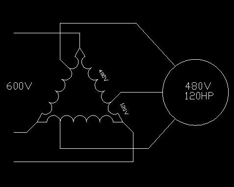

Need to run 120HP of motors.
Any rational way to inexpensively drop down 600V on a portable system to 440 3Ph like with a buck boost or autotransformer?
Or must I go with a regular dry type isolated transformer?

Bill; Thanks for the info.
The motors exist already.  They want to run the system on the already available 600V.
Check my math here if you would please.
2 x 60HP = 120HP
(460V x 154A x 1.73)/1000 = 122.5kVA
Heavy duty starts more than once an hour so
122.5kVA x 1.2 = 147kVA
If I use three transformers (not open delta)
147kVA / 3 = 49kVA per isolation transformer.
But we shall use autotransformers so:
The ratio is 480 and 120 so 4/5 and 1/5
The transformer core has to carry 1/5 of the VA since it is only transforming(bucking) the 120.
So the transformer only needs to be:
49kVA x 1/5 = 9.8kVA or 10kVA.
Have I missed anything?

Hi Keith. With your configuration, you have a hard time finding the right ratios for the voltage you need. I have never considered that configuration, so I have never worked out the actual voltages. I think you may find that your delta connection give approximately 90 V drop rather than the 120 V you are looking for.
A star configured auto transformer gives a symetrical system, but:
It may be difficult to find the correct voltage ratings. You would be looking for a 277:70 V transformer. You could use 480:120 V transformers but you would take a capacity hit. Your KVA ratings would be 277/480 or 58%.
I prefer an open delta auto transformer connection, similar to the connection used in autotransformer starters. There is no phase shift and no reduction in the KVA rating. If you must do arc flash calculations, one line is direct and the other two are limited by the transformers.
If you are using sensitive ground leakage detection, your resistive and capacitive leakages will be higher on two phases. If you mount the transformer close to the motors this difference will be minimized.
In open delta, each transformer must carry full phase current. The boost windings must carry the motor current plus the primary current.
I would use the current (154 A) times the effective ratio (5/4) times the voltage (120 V)/1000 = 23 KVA. I would use a pair of 25 KVA transformers. A set of 15 KVAs at each motor would give a greater starting margin and a more dependable system.
Tip; I don't factor extra duty for frequent starting into my original calcs. I work out exactly what I need and then see how much extra capacity I gain going up to the next standard size transformer. I often find that I have a good margin with the smallest suitable standard transformer size.
In regards to star versus open delta, how much do you want to pay for symetry?
Bill

To get 480V from the diagram as drawn, you need 516 and 84V  Remember you need to vectorially add the two voltages.  With 480 and 120 the resultant voltage to the motor is 433V.
Three autotransformers in wye or two in open delta as suggested by Bill would work much better.  Or a 600V VFD set with a maximum output voltage of 480V.
RE: Transforming down from 600V
Thank you for the correction David. Now that I take a second look, your figure of 433 volts looks better than my estimate.

Yow.  I missed that.   See this is why I ask you guys.
For this retrofit the original motors are actually nameplated,(my contact sez), at 440V not the more modern 460 or 480.  So I might still be okay on the voltage ratios.  I will mull that over some more.
This is all just a budgetary issue for someone, to go to someone, with a proposal, to do an refurb verse a new unit.
