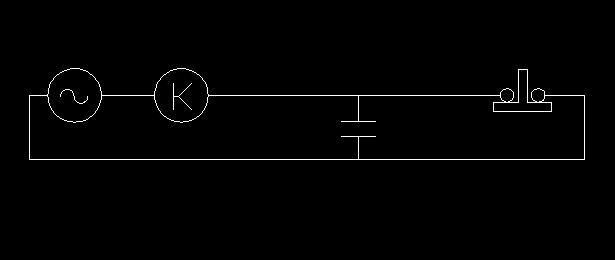

I find this post to be very helpful due to the fact that I have run into similar problems recently.  I think I understand where this capacitance comes from and why is causes problems but I was hoping to get a theoretical explanation.
Is this capacitance due to the long wire run causing a large capacitance to ground?  When control power is removed relays and inputs may not drop out immediately due to the fact that the wire created capacitor has to discharge?  Am I on the right track here?
RE: Control Cable Capacitance on Conveyor
Nope not to ground but to the return.
Note the picture I drew below.  See that capacitor?  If it gets large enough then the switch, way at the end becomes superfluous.  It doesn't interrupt anything.
As the wire run gets longer that capacitor get bigger.
Keith Cress
controlsdude;  My schematic shows the powersupply on the left.  Mounted somewhere near the COIL for the safety relay. And a normally closed push button out in the field.(not a remote contactor)
The capacitance is the per-foot-capacitance of the cable used to hook up the E-Stops.
If you use a bonafide cable you are likely to have a higher per foot capacitance in your safety line than if you were to just use wires dragged thru a conduit.  If your two wires were somehow held 3 feet apart you'd have even less capacitance.  You might be able to run the system 10x  further.  You would start incurring other problems doing that however, as now a lightning bolt would couple even more energy in thru the resulting loop.
So depending on your specific wire, wiring practice, distance, and relay you will have varying problems depending.
No. Because the current is the issue.  Current caused by the circuit capacitance.
If you ditch AC then the whole capacitance issue goes away.
Roy,
The problem with long ac runs (depending on the configuration of the circuit) is the shunt capacitance and the resulting capacitive reactance between the conductors.  With a dc circuit, the capacitive reactance is infinite because the frequency is zero.
