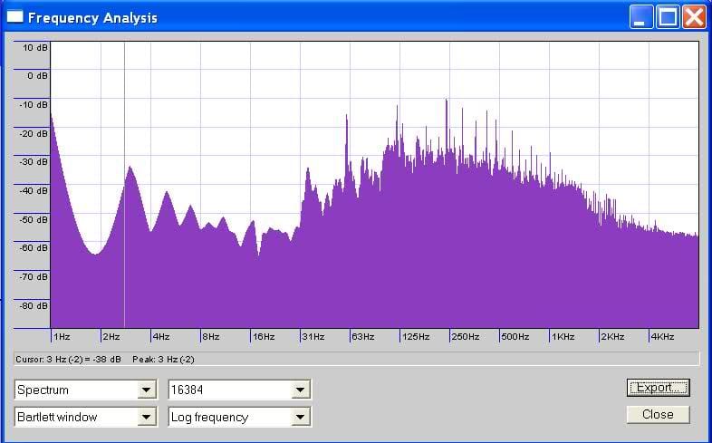

I'm in Canada. The sound is hard to describe. They tried to record it with a digital camera, you can try to hear it, (you need headphones), behind the transformer humm, there's this strange noise about twice per seconds, (it sounded louder on the field).

I can hear it very clearly too.  Not sure I'd call it 160Hz.

He said 180 clicks per minute, not second, I counted about 3 clicks per second too.
RE: strange noise from transformer, partial discharge?
You're right it sounds like 3 per second.
Oh, and he said "160" per minute.
Notably when I strip the 60Hz hum out the sound diminishes by the same amount.

I keep messing with that sound file in my spare time.
I think that noise is just an acoustical result of the three phases humming or beating in some way.  ANY filtering, low pass, equalization, etc., ALL reduce the mystery sound just as quickly as the targeted frequencies.  How can this be if it is a true ~3Hz source?
