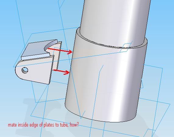

another mate queston, plate edges to tube, again oddball angles
RE: another mate queston, plate edges to tube, again oddball angles
To place this part in the assembly, take a close look at what really has to be connected...
It is impossible for te faces of the plates to match the faces of the cilinder. What will happen if it's placed right? The edges of the faces will be on the cilindric surface. To accomplish this, use the 'connect' relationship.
After placing two 'connect' relationships, the part is not fully constrained yet, it will move along the cilindric surface, up and down and around. So you will have to put in a 'mate' or 'planar align' to constrain height and position...

Arlenn,
Assuming the three plates are a subassembly, you could create a sketch from the top view of a circle that matches the diameter of the tube.  The edges of the circle will be connected to the inside edges of the vertical plates.  Return to the main assembly and use an axial align between the circle (show sketches in the plate subassembly) in the sketch and the axial centerline of the tube.

Kyle,
Thanks, that worked pretty well.

The connect relationship only works for points, lines or planar elements. (in V19 - not sure about V20).
I agree it ought to be possible to connect a point etc to a curved surface.
In this case, to constrain the side plates to the cylinder you can use a Parallel relationship between the inside edge of one (or both) plate(s) and the cylinder, defining the offset distance equal to the radius of the cylinder.
Then add align/mate/angular relationships to fix the rotation and height positions of the bracket on the cylinder.

Inv. and SW, just plain allow the Tangent mating of an edge to a curve. or a face to a curve.
They also have Axis and point elements, not just planes, which are also nice, an axis can be mated to axis.
there is no Connect; lines, axis and points can all be connected though Mate.
