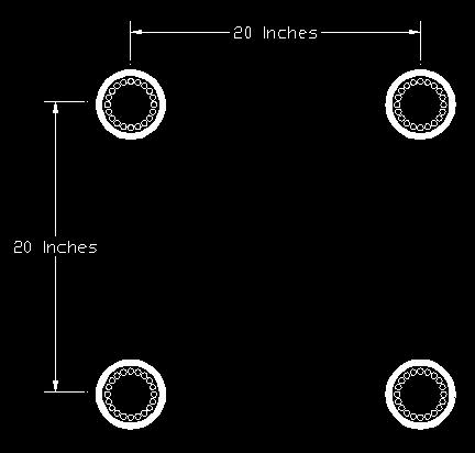

I have a case where four burners, (100-150kBTU), need to be ignited at the same time.  They're all mounted in a square pattern about 20 inches to a side.
They will be automatically cycled.  The configuration contemplated is a pilot tube running around the entire perimeter.  The customary thermopile monitoring the end of the pilot tube.  At first glance I'm not comfortable with this method as I've seen areas of pilot-tube-like burners go out for various reasons.  This of course would mean a burner going on for a while unlit. (bang) Heck, it could mean three of the four burners going on for a while unlit!
Is this a typical solution or is something else more commonly used now?
I was looking at individual electric ignition detection systems and considering using one per burner but this gets kinda pricey at about $200 per burner.

I've always put controls on every other burner. The uncontrolled burners will ignite off the controlled.

So in this scheme you'd maybe use two igniter/provers on a pair of the diagonal corner burners?

Please give a little more description of your gadget.  In your OP I didn't get a picture of diagonal corner burners.  Maybe it is just the old boiler guy in me but I envisioned 4 burners on one wall in a square pattern.

like rmw, a quick picture is worth 1000 words.  If you number the burners, then others could jump in too.
RE: Multiple burner ignition schemes.
Sorry rmw;  I'll give it another whirl.
All burners point straight up.

This is big enough system to make sure you have flame detection and shutdown.  A pilotless ignition is good for lighting, but you'll need a control system to detect flame out and either initiate a restart or shutdown.
you say the burners will be automatically cycled, will a pilots heat be lost, if not, then a pilot is much safer than auto ignition of the entire buner, it would still be best to ignite a pilot, which in turn ignites the burners once a flame is detected.

outfit each burner with direct spark ignition with flame rod supervision.  These control shouldn't run you more than $30-50 each burner.  Look at Honeywell S87 controls.

Sorry... OEM pricing on the S87 is not $300.  List may be that high, but actual price after multiplier is very low.  Also, since you said "automatically cycled", I assumed you had gas valves in the system.  I could give you some more ideas if I knew more about the system as a whole and the budget.  Can I call you Monday @ Flamin?
