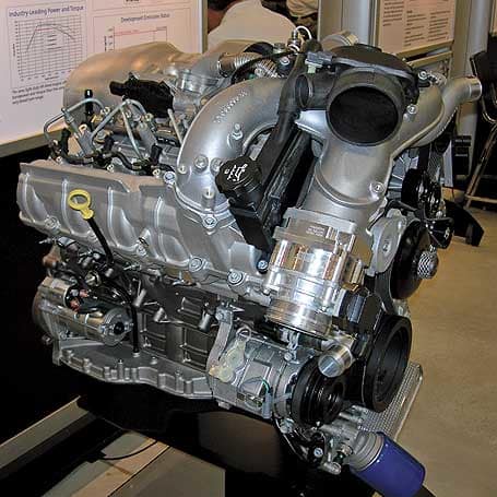

Despite all the nay sayers putting down the reversed diesel head layout (exhaust in valley of V) in thread71-184766: Diesel design paradigm - V6 & V8, GM has announced the 2010 Duramax V8 diesel will use this layout.  It definitely offers some packaging advantages as well as challenges.  Hopefully GM will sweat the details on this one & not unleash another "Oldsmobile diesel" on an unsuspecting public.

        In my opinion, the primary reasons for choosing this layout were packaging constraints.  GM probably wanted the diesel to fit in the same space as the gasoline engine.
RE: New GM diesel
Yep, thats what the article (you obviously didn't read) said.
This news makes me feel like a prognosticator with my previously mentioned post. smile Its surprising that the engine is only a 4.5L but they had to go with the narrow 72° bank angle and no manifolds to keep the engine narrow enough? Makes me suspect this will end up in the smaller SUVs and trucks.
I would hope that the intake flows well with the near vertical intake port. I also wonder if having the intake cover the cam helps with NVH? I think the rib on the cover is big enough! I wouldn't be surprised if they add some type of high temp cover over the exhaust cam to satisfy marketing and improve NVH some more. I also noticed that the covers on this picture are different? (http://blogs.edmunds.com/Straightline/2935)

"the primary reasons for choosing this layout were packaging constraints"
Sort of.  It's all about emissions controls.  The DOC needs to be as close to the exhaust valve as possible. Putting the turbo in the engine V keeps the exhaust plumbing short going into the DOC, and thus keeps the exhaust gas temps high.

IceStationZebra - I remembered you original post but it was closed so I had to start a new one.  This engine is DOHC so they had to go to the lower displacement and narrower valve angle to stay inside the SMB envelope.  However, it looks to me like it is going to be a bit taller than a SMC.  I think there will be a big market for this motor in light duty pickups & SUVs.
I would love to see how they are keeping the intake air & valve train/cam lubrication separated.  I can't quite picture it myself.
"The heads' unique two-tiered internal construction segregates the intake route, the chain-driven DOHC valvegear, and water jacket. (The fully dressed engine on display was not sectioned, so no internal details were revealed.)"

I thought about the DOHC setup being wider AFTER I posted my reply. I could also argue that it must have a bore large enough to accommodate 4 valves & injector - so being an 8 cylinder of only 4.5L the stroke probably isn't overly long and therefore a reasonable deck height. But I do have to agree that it looks tall.
As for the intake I think there is a plenum above the intake cam and the ports wrap around the outside of the "cam cover." If you look closely you can make out 4 bulges behind were the intake connects to the cover.

A current discussion in another forum involving balance shafts in another automotive Diesel engine, plus the offset crankpins that an unusual 72-degree V-angle requires, and the weakening they cause the crankshaft, can be no good things.
RE: New GM diesel
http://en.wikipedia.org/wiki/BMW_N63
features a reverse-flow air design in which the turbochargers are mounted in the engine valley and the intake manifolds are located on the sides of the block. This new design creates a more compact engine package and reduces the width of the assembled engine. The engine uses air-to-water intercoolers, which is more efficient and orvides a shorter air path than using a standard air-to-air intercooler.
Interesting considering how much hotter a petrol engine runs compared to a diesel, and they've kept with two turbos as well, so it isn't as if their only goal was to keep the exhaust manifold lengths down on a V engine with one turbo
