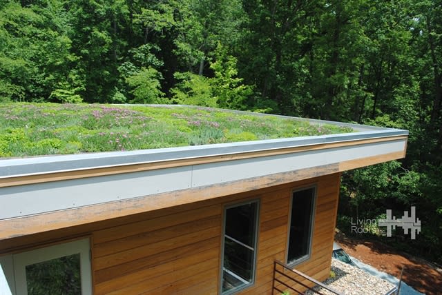

ASCE 7 specifies 100 psf live load for special purpose roofs.  Would you consider a "green roof"  to be a roof garden as noted near the end of chapter 4 such that the special 100 psf live load is required?
For this puropse let's assume that people are not meant to walk on this roof; it's only meant to be green without access for the public or assembly.  The garden roof will be similar to these.  We don't know which has potential for selection at this point.

The type of green roof in question is "engineered" to be light and doesn't have typical soil with plants (see link above).  The company's website lists weights from about 18 psf to a little over 45-50 psf or so.  Sometimes you can find them specified with a dry weight and wet weight.
As stated above, it seems difficult to justify special roof loading of 100 psf live load if there is no access to the roof, but then I've been wrong before.  That's why we have eng-tips!  What would be great would be some literature convering this topic.
RE: Green roof live load
Section 1607.11.2.3 of the 2006 IBC is for landscaped roofs.  I think this is more along the lines of what I'm thinking.  This section provides for 20 psf live load and the weight of the landscaping is to be dead load and is to be based on the saturated soil weight.  Makes sense to me.
I didn't find this earlier because we don't use the 2006 IBC in my state and the ASCE 7 does not have a corresponding section.
This came about because a coworker is saying we should use the 100 psf for special purpose roofs.  I'm interpreting this requirement to be based on assembly and not applicable where there is no access for assembly.
What do you think?

If people arent meant to walk on the roof then it's a landscaped roof. 20psf LL
If people can go up there, then its a garden.  100 psf LL
A garden is something people interact with, landscaping is not.  Hope you straighten you college out.
