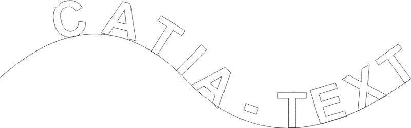

I think that I know the answer, but anyway is it possible in V5 R17(MD2 or HD2) without 3rd party software... that text follows the curve?
Rgds,
Damir
RE: Text along curve
Damir, No
Derek
I hate to be right :))
Thnx
Today it did not pay.
You can write letter by letter and move them in the right position....I remember on COE forum there is somebody who create a Power Copy for letters or you can use  also http://www.2htts.com/CATBlog/index.php?itemid=34
