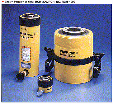

Hi everyone, I was hoping someone might be able to help me find something.  What I'm looking for is a cup style air cylinder with a hollow center.
It is something similar to this:
That is from a kit that is used to fit over a conventional coil over setup for a car to raise and lower the ride height.  They seem to be low pressure because of the fittings that are on it.
I have been looking all night, and can't seem to find anything that will work for it, maybe I'm just not looking in the right place or don't know what something like this would be called.  So I'm hoping someone else on here has come across something like this and might have some leads for me.

What I would really like to find is essentially a metal expanding donut.  Basically a spring spacer that would increase height with air pressure.  I am also open to other ways of changing the height of the spacer.  But I'm not having any luck finding anything or figure out who the best place to talk to about something like this would be.
The biggest constraint is the need for the center to be open.  Which is making it hard to find.

The pressure required would depend entirely on piston area. It should not need all that much to hold up a car.
The little guy in this picture will lift 12 tons and has a .77 hole through it.
