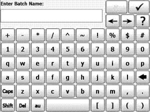

Paperless recorders can store not only the analog temperature data, but text info as batch identifier info.
We use a Honeywell QXe recorder to do similar steps, with the exception that our runs take 20-30 minutes and generate a chart.   But the chart could be as little (or short in time) as you need.
The touch screen has a QWERTY keyboard to key in the ID data.
A screen prompts for ID data in any of 4 fields:
http://www.lesman.com/unleashd/catalog/record/record_eztrendqxe.html
