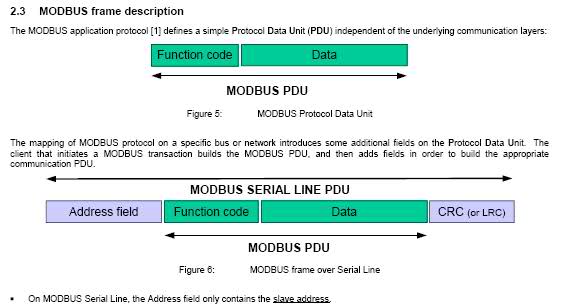

Can anyone give me a brief idea of what the term frame refers to concerning PLC programming.
I believe it has something to to with the configuring of comms ports to communicate with external devices but want to know more

This type of PlC is manufactured by Harland simon, the code is similar to ladder logic but tends to function on a lower level. I have been doing some poking abut and it has become apparent that it is something to do with preparing a block of data to be sent over a comms port
RE: frame?
Are you thinking of serial character framing?  For comms through a serial port of a plc?

thanks i think that adds up now
