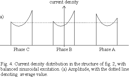

Here's a link to some pictures of current distribution on a busbar with very basic geometry:
Three flat parallel conductors spaced one width apart. (Sorry, I don't know how to attach pictures directly.)
http://www.multi.fi/~saunaaho/SSa/
Please select the file SkinEffectInMultipleAndPolyphaseConductors.pdf
The picture 4a seems to explain also the question of reverse measurements by Davidbeach.
The picture is from article “Skin effect in multiple and polyphase conductors” by P. Silvester and was published March 1969 in IEEE transaction on power apparatus and systems. Page 231. (According P. Graneau the figure 4 makes history being the first of its kind.)
There is another article, “Finite element calculation of Eddy currents and skin effects” by John R. Bauer, in IEEE Transactions on magnetics, March 1982, page 504 , where the same busbar geometry has been calculated using finite element method (FEM).
My colleague used a Fortran program (FEM?) on late 70' to calculate current distribution and short circuit forces in three phase high current multiconnector busbars with various geometry. I wasn't involved but I remember that structure with a decently even current distribution was hard to find, because of skin effect and proximity effect.
Here's a small example of such multiconnector busbar and the ineven current distribution:
http://www.edadesignline.com/showArticle.jhtml?articleID=192200580

No password is needed (my colleague tested the link via an other ISP than mine) for
http://www.multi.fi/~saunaaho/SSa/SkinEffectAndProximityEffectOnCurrentDistribution.pdf
However, here's a second try. First the geometry of the busbar:
and the current distribution
This figure 4a does better correspond to the original question. There is only one conductor per phase, but the current distribution gives an idea how current would distribute if the conductors were splitted to two parts. The distribution is quite similar with the 7carisfast's original case. In any case, the position of the six individual motor cables and the cable tray are essential to the actual current distribution.

Hi.
I would like say many thanks to 7another4 and Runsor.
Your information was help us solve big problem.
Current distribution was same as in Fig 4.
