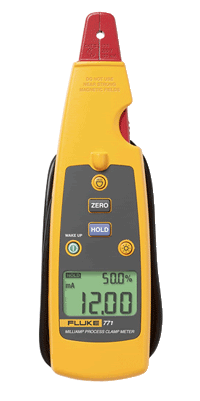

RE: What is the best analog input? 1-5V or 4-20mA
Fluke just introduced a clamp-on instrument specifically for process loops which does not require the loop to be broken. I'm thinking of getting one, just for the convenience it brings. Maybe next year with a new budget!
http://us.fluke.com/usen/products/Fluke+771.htm
If we learn from our mistakes I'm getting a great education!
A friend of mine just bought one of Fluke's "clothesclips". He talks a lot about how easy things are nowadays.
Looks to be a handy unit for loop checks.  I finally saw one of the Fluke's live at a trade show last week.
It has a white LED 'flashlight' on it to light the area by the pincer sensor clips.   Backlit LED display can be turned on or off.
It is not rated for hazardous areas, so safe areas only.
I stood on the opposite corner, watched and counted 24 guys over 10 minutes who came up and handled the 3 meters on display.  A very popular item for a PLC show (Rockwell's Automation show).
It's not a calibrator, it seemed to be good to ±.03mA (comared to the source's digital readout) but they aren't claiming it is, either.
I budgeted for one.
