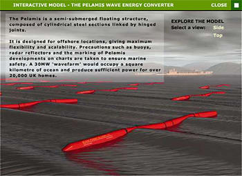

The first commercial wave farm has been exported to Portugal by Edinburgh-based Ocean Power Delivery, their Pelamis wave machine is at the cutting edge of marine.
“Each joint of the Polamis or “sea snack”contains a hidraulic pump. As wave move the section high pressure oil is pumped from the joints through motors, wich drive the generators that produce electricity.”
Go to the site bellow to see an animation of the system.
http://www.oceanpd.com/Pelamis/default.html

On the other hand, the animation here wasn't that slick and didn't in fact reveal anything at all. I would have thought we could all envisage from the photos what would happen to the sausage string when the waves hit it so what i was expecting when i clicked on the animation was to see the action of the hydraulic generators illustrated. I suppose this lack of "sickness" should actually persuade me this is going to be the best thing since sliced bread.

I've been aware of this for several years now, I thought it looked pretty good.  They tested a subscale one a while back and last I looked at the website had a full size one off the coast of one of the Scottish Islands.
PSE, they capture the vertical motion by the fact the sections move relative to one another, at least that's my understanding.  As regards damping, I believe they control this so it doesn't tear itself apart in strong waves.

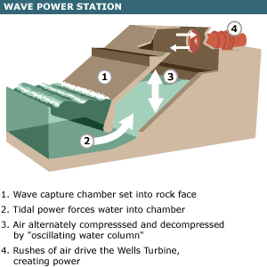

What about tidal power?
RE: Polamis tidal power in Portugal
Pelamis in a certain way is a form of tidal power
luis marques
Um, Sompting I added that as an after thought in brackets "(maybe tidal thinking about it)" as tides depend on the mass of the sun & moon.
0707, I really don't think Pelamis is a tidal power generator.  The different segments would rise fairly uniformally with the tide.
The wave power station you show would generate some power from tides though very little in comparison with waves and only twice a day (or 4 times if bi-directional).  In fact unless there's a very fast tide I doubt the rate the air is forced out by tides would even turn the turbine.
