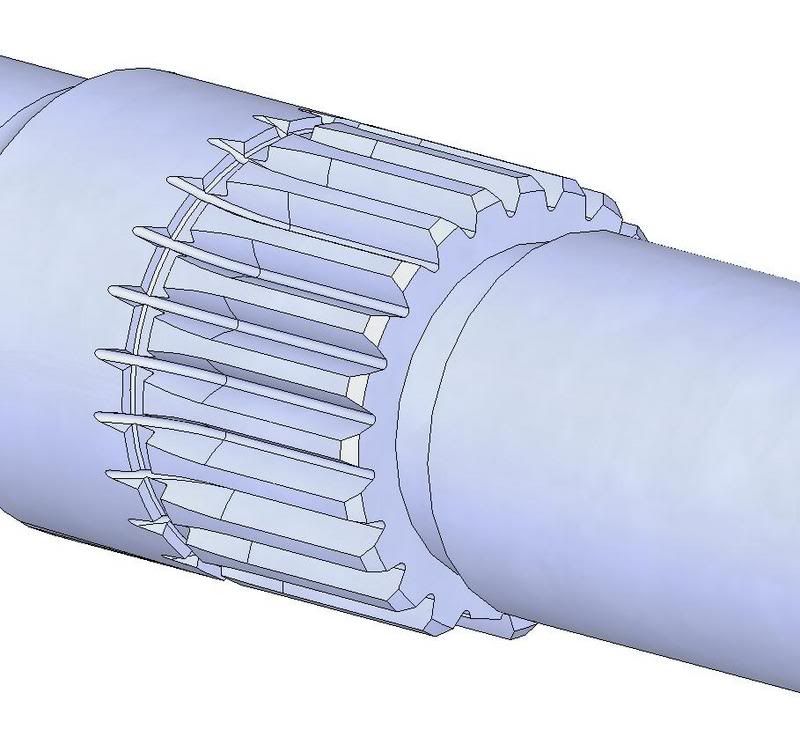

I am attempting to draw a 19T, 32/64 30Deg. Pressure Angle Class 5 Spline.  I have not had much experience with splines and gears.  I am using AutoCAD to draw the spline.  Is there a calculation to use to draw the profile of the tooth?  I am not sure how to go about drawing the radius on the side of the tooth.  Any help would be greatly appreciated.
TIA

It is not a radius but an involute similar
to an involute on a gear.  Any gear book will
give you the equations to draw an involute or
you can search this forum on involute and find
a program to do what you want.

Unless you're doing it for fun, or if you need accurate surface geometry of the spline for some reason, it's probably not necessary to draw the spline profile perfectly.  The spline itself will be shaped/hobbed/rolled based on the information you provide in the spline data table on your drawing, not on the 3D surface data in your AutoCAD model.
But as dimjim noted, a good reference like Machinery's Handbook will give you a procedure for generating an involute tooth profile.  Of course, the profile you generate will only be a nominal profile, and will not have the necessary corrections for the class 5 tolerance you have specified.  If you really must have an accurate CAD model of the spline, I would recommend purchasing an add-on application for AutoCAD that will produce accurate gear and spline profiles, with all of the necessary corrections.
One package that I have used, and seems to work well, is GearTrax: http://www.camnetics.com/products.htm
Good luck.

I have looked in the Machinery Handbook and am unable to find information on calculating the involute.  Is there a way to get the ANSI B92.1-1970 standard for free?  I thought that might be another way to find the necessary information.  Also, does anyone know what calculations I could use to find the involute?  I have everything else drawn but the tooth profile.

RE: involute spline question
Where I work, we use AutoCAD LT and it doesn't seem to have the ability to use LISP routines, so I used the method in the geometrical construction section of the Machinery's Handbook for constructing the involute curve.
A polar array can divide the circle while the divide command can be used to give you the arc lengths. For the arc lengths I drew a line equal to the circle's diameter, scaled that by pi, and divided it into the same number of segments as I divided the circle. The more segments, the finer the resolution.
I used a base circle of 1 for my curve and paste this in as a block scaling to the desired base diameter.
From there, I position the curve based on measurements over pins.
Who's cutting the spline for you? I'd call them for this dimension as they'll have the program for that calculation. Unless you're doing this every day, it's tough to justify the expense for your own program.
This method isn't perfect, but it's close enough that I can use it to give me dimensions over alternate pin diameters.
rharr,
for the ACAD LT you can calculate the involute points in Excel and import (copy-paste) it in the ACAD script file (*.scr)
ACAD LT accepts scripts and will draw a perfect curve through the precalculated points. It is a tested method - I did it when I used the LT.
Involute curves take an age to create, gobble up bites, make the drawing unwieldy & can cause prob's in 3D. I always approximate the involute to a radius struck from the base circle tangent to the pitch circle flank intersect. the errors at the tip and root are small. Slines are hobbed and broached/shaped and so there will be no problem with machine tool data transfer.
If you are "dimensioning" the spline for base tangent (across several teeth) either rotate one set of flanks to the correct dimension (usually defined by the spline standard) or if it is permitted in your system, edit the dimension. The same goes for pin dimensions.
I never had problems with involutes on higher level CAD, 3D included. Just slightly larger files.
Can be problem in Autocad, I did not try it.
The accurate curve is necessary if the file will be used to EDM the splines.
I concur with gearguru's comment about EDM. You will though, be surprised to learn that in my experience, broaches are made closer to a radius than the involute. The errors are lost in the fit.
