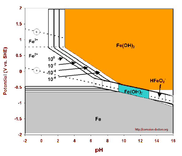

Hey there Group
In boiler feed apps the metal of the mech seal often
get a red/brown coating on it.
Is this Ferrite?
Im looking for info on the source of the ferrite in these apps and how it can be dealt with (mag filters? and the like)

No. It is probably iron hydroxide in the form of rust. There is iron transport going on (corrosion) in the boiler waterwall circuit and it should be investigated.

Red-brown sludge is almost certainly rust as mentioned by metengr; usually written FeO(OH). The color is a good indicator of Fe+3. Copper immersion plating out on iron cannot build up to a pasty mess (unless the iron is really spongy).
Probable cause is high oxygen and maybe also low pH. Look for a Pourbaix diagram for iron-water in a corrosion or water treatment book. You want to maintain conditions where an Fe+2-containing phase (Fe(OH)2 or Fe3O4) is stable in contact with Fe.
http://www.argentumsolutions.com/tutorials/thermexpert_tutorialpg4.html
http://www.corrosion-doctors.org/Thermo/ironE-pH.htm
There are too many variables to show everything on a single diagram for a given temperature, so you will find one type with the oxides given and another with hydroxides:
"The orange zone indicates where one could expect to see rust" -- (from corrosion-doctors link)
