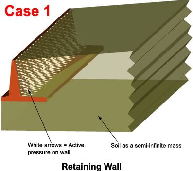

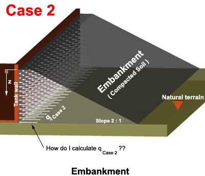

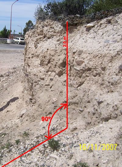

Another related doubt:
Is there any difference in the forces exerted on the walls by the soil (read: active pressure) when the tank is underground (Case 1) and when it is above ground and the walls are earth-embanked (compacted soil embankment in Case 2) ?
For example, a geotechnical report of a given soil states:
Quote (from a real soils report):
Horizontal Pressure on walls = Pa = 0.65 . ka . g . z , where:
[Pa] = [Kg/m2]
ka = 0.3
g = 1800 Kg/m3
z = depth
So, Pa = 0.35 . z
Now, if I recall correctly, this relates to retaining walls or (underground walls for that matter) where the soil is a sort of a semi-infinite continuum, but how does it relate to an above ground embankment with a 2:1 slope as shown in Case 2 ?
Specifically, is there a drop in 'ka' in Case 2 ?
See figures:
Anyway, my common sense says that once you place compaction equipment, tractors, etc. on the embankment, the formula for 'Pa' above becomes completely useless.
Thanks.
RE: Slab on grade cast on compacted soil
Only if the structure can tolerate angular distortion (i.e., hinged at the foundation) on the order of 1 inch in 10 ft (2 inches in 20 ft, etc.) should you consider active earth pressures.  For a tank, I'd base the earth pressure on the at-rest case.  At rest earth pressures are typically 50 percent greater than active earth pressures.
I'm not familiar with the form of the expression that you provided in your quote from the geotechnical report.  For me active earth pressure is based on tan^2(45-phi/2) - let's say about 0.33 for a typical soil.  So you'd take the unit weight (120 pcf) and get an equivalent fluid density of about 40 pcf (0.65 g/cc).  For the at-rest case, maybe you'd use 60 pcf (1 g/cc).
When dealing with sloping backfill, DM7.1 or DM7.2 (Navel Facilities Engineering Command - available on line for free) provides graphical solutions for the active case.  I'd recommend that you solve the sloping backfill for the active case and then multiply that coefficieint by 1.5 to estimate the at-rest earth pressure coefficient.  To use this graph, you need to know/estimate the friction angle.  Now you just have to get a fix on the unit weight and voilla, you can solve the problem!
Regarding the use of compaction equipment I'd apply a "construction surcharge" to the calculated earth pressure.  This construction surcharge would likely affect just the upper few feet.  For the case that you have 10 ft of backfill (maybe that's too much?), the stresses of compacting the initial earth fill may not exceed the final earth pressures.  However, as you compact the earth fill at the top, that's another story.  Some folks recommend 90 to 92 percent compaction for soils adjacent to walls (i.e., overcompaction is not allowed) - just make sure that the soil will have sufficient strength for the intended slope angle.
Good luck.  Thanks for the nice graphics, it really helps the discussion.

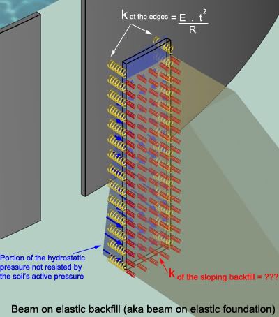

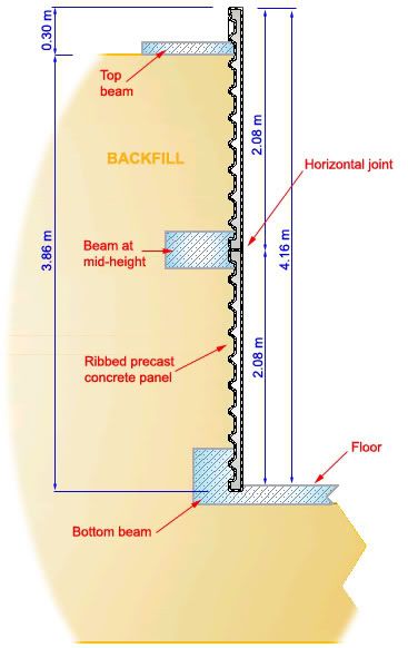

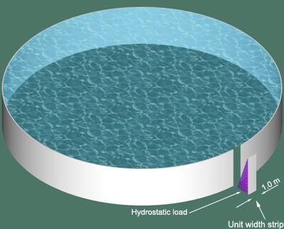

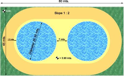

Hello, I'm back again.
I'm having a difficult time estimating active and passive pressures from the sloping backfill for a project I'm currently working on. The project consists of two neighboring circular concrete tanks (Height=4.16m, Inner Diameter=26.10m, Wall Thickness=0.10m) with a compacted external embankment. As both tanks are identical, I've limited to only one of them the following study of the pressures involved.
The wall cross-section is like so:
And the backfill is implemented like this:
Cross-section:
Isometric view:

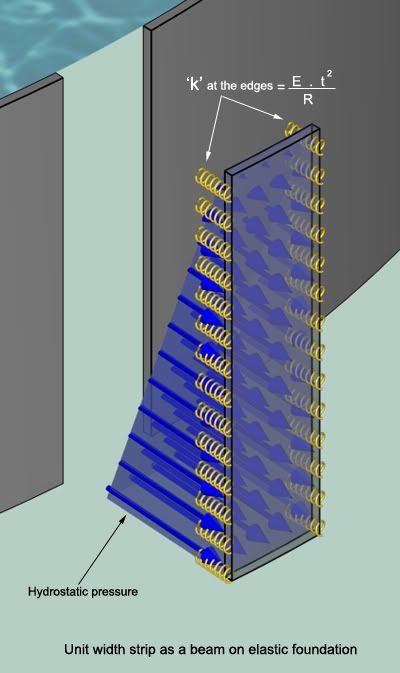

I'd need clarification on some conceptual points that I don't fully grasp.

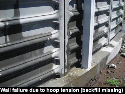

Earth backfill is what makes the whole system structurally sound. Precast panels are not stiff enough on their own to resist hoop tension or vertical bending moments. That's why the backfill becomes mandatory.
    Sidenote:
See what happens when the contractor "forgets" to do the backfill:

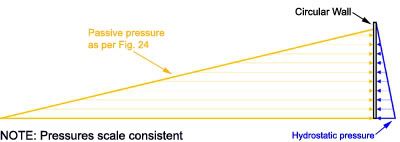

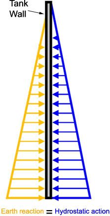

Now to the calculations, could you please confirm if the following reasoning is correct?
Passive Pressure
When the tank is filled, the backfill has the potential to counteract internal water pressure up to a maximum given by the passive pressure.
- OR -
To counteract hydrostatic load, the backfill can contribute a pressure whose upper limit is the value of the passive pressure.

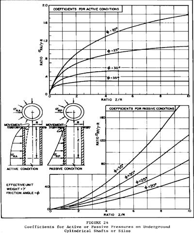

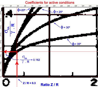

Quote:
From ufc_3_220_10n.pdf, a "Unified Facilites Criteria" on Soil Mechanics by the Naval Facilities Engineering Command, page 223:
5. PRESSURE ON VERTICAL SHAFTS.
a. Shaft in Sand. In the excavation of a vertical cylindrical shaft granular soils, pressures surrounding the shaft approach active values. If outward directed forces from a buried silo move the silo walls into the surrounding soil, pressures approach passive values as an upper limit.
(1) Pressure Coefficients. See Figure 24 for active and passive pressure coefficients for a cylindrical shaft of unlimited depth in granular soils.
(2) Modification of Active Pressures. For relatively shallow shafts(depth less than twice the diameter), rigid bracing at the top may prevent development of active conditions. In this case, horizontal pressures may be as large as at-rest pressures on a long wall with plane strain in the surrounding soil. (See DM-7.2, Chapter 3.)
Reference:
ufc_3_220_10n.pdf can be downloaded here.
So, if I'm on the right track I can use Figure 24 from that document to estimate the passive pressure that the wall would have to apply to the earth mass for the whole system to fail.

Z / R = 3.86 / 13.15 = 0.3
Then, from the passive pressure graph I get σRP / (γ . R) = 3.25
I must admit shallow cylinders like this tank configured an edge case for the graph author. I had to zoom-in and place rulers to get as accurate a reading as possible. (I don't know how valid the readings are for edge cases like this).
Anyways, going ahead: σRP = 3.25 x 1900 x 13.15 = 81,201 Kg/m2
Here is the pressure diagram (scale consistent):
Obviously, by no means can the earth reaction be any different than the hydrostatic action. That was just an upper limit. It's as if the soil said "if needed, I can respond with pressures up to 81,201 Kg/m2". In other words, that number cannot be used in the calculations. When the system is in equilibrium, the actual diagram would tend to honor Newton's third law. Simplistically:
However, these 81,201 Kg/m2 are half of the story. This number explains failure from the soil's point of view only. I think Figure 24 assumes that the underground cylinder can deform elastically whatever magnitude is necessary to push the surrounding soil up until 81,201 Kg/m2, the threshold that produces the soil's failure. That's not the case of a concrete wall. It's deformations what triggers concrete failure, not the stresses in the soil mass.

The specialized literature on tank design treats a circular wall subjected to hydrostatic pressure as a beam on elastic foundation. A strip of unit width is isolated and analyzed.
For the simple case in which no backfill is involved, the modulus of the foundation 'k' is E . t2 / R and the problem has a closed-form solution. Actions, reactions and deflections can be calculated easily.
(E = Modulus of elasticity of concrete, t = wall thickness, R = radius of tank)
Now, how do I weigh the effect of the external backfill? Leaving compaction aside, I think the analysis is twofold:
Firstly, there's the at-rest pressure thing (P0 = 1.5 x Pactive) with its triangular loading diagram. If the at-rest pressure is smaller than the hydrostatic pressure, then the latter is counteracted by the former until the former runs out, so to say. The passive pressure then deals with the remainder of the hydrostatic pressure. More on this shortly. It could happen that the at-rest pressure is greater than the hydrostatic one. In this case even when the tank is full the walls will be compressed and the passive pressure never comes into play.
Secondly, back to the scenario where P0 < hydrostatic pressure. Here the walls start pushing into the backfill after the at-rest pressure is fully consumed, the wall then -I think- behaves pretty much like a slab on grade. Now we have a new player: the modulus of subgrade reaction 'k' of the sloping backfill that will participate in the equilibrium of the wall subjected to the portion of hydrostatic pressure not resisted by P0.
So, the first million dollar question is:
Does my convoluted reasoning make sense?
If so, what's the value of 'k' for the backfill ? Is it constant along the full height of the embankment?

To estimate the at-rest pressure I go back to the same Figure 24 cited above (active pressure graph):
Then, Pactive = 4,048 Kg/m2

A 90º cut on the at-rest stockpiled soil that will be used for the sloping backfill suggests that active pressures, if any, can't be that big.
Even more, the soil on the picture is naturally consolidated, not mechanically compacted as is common practice with sloping backfills.
So, the second million dollar question is:
What is the "real" active pressure?
4,048 Kg/m2 from Figure 24 ?
0 Kg/m2 like the photo suggests ?
Or something in between ?
Is it safe to use the graphs from Figure 24, even when short cylinders represent an edge case?

Remember from my previous post that the full height is achieved by stacking two cylinders:
Then, with the last picture in mind, where do I measure the horizontal displacement 'Y' so that I can use it in Figure 1? Is it the largest 'Y' from span AB, for example ?
