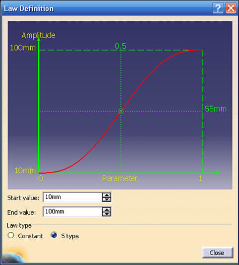

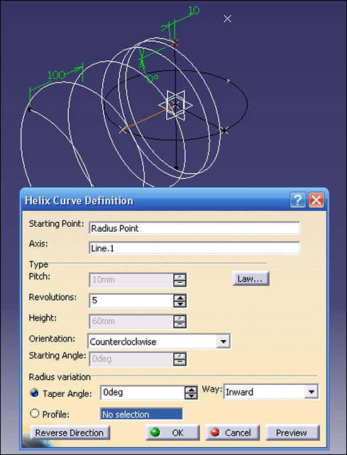

I forgot to add that the Revolutions option becomes active when a Pitch Law is used. Variable pitch helices are obviously quite a different case to the Constant Pitch Helix in question earlier.
Here's a Variable Pitch 'S' Law case with the pitch after one turn being 10mm, and at the last turn equal to 100mm.
The Pitch box has now been nulled, the Revolutions box is active.
This is the Law being set up...
If you wanted a specific Law - such as a helix whose pitch accelerates in a parabolic manner, and didn't slow down then you could draw the law - somewhere in the model.
