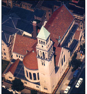

Shaman2,
Here's a good photo of a sheathing failure of a roof from my current case file.  In this particular situation, the sheathing wasn't described as collapsed because the mastic on the roof shingles was holding what was left of it up. Rarely is the situation you describe called a 'collapse'.  It's too big of a word and implies a dramatic event.

RE: definition of COLLAPSE
Thanks Cass.
I would agree on the pic above because what is holding it together is still part of the building. In the prior case I am picturing the cabinets as freestanding furniture instead of being part of the building. Thus I would have said it had collapsed onto the furniture, whether the furniture was full hight or three foot high, under the definition that to collapse is to give way. However I note several other definitions( in Mirriam Webster) require the collapse to be sudden, and who knows how suddenly the joists fell to the top of the full height cabinets. Did in happwn as slow deflection over years, or suddenly one night when a storm was shuddering the house.
This is an apse roof
casseopeia image is an out o apse roof so it is a roof in collapse
cheers
